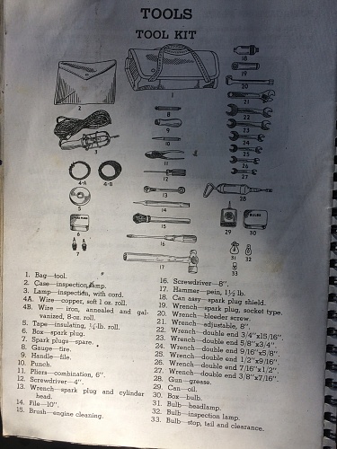

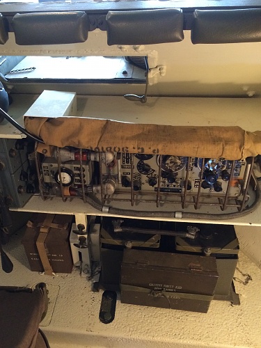

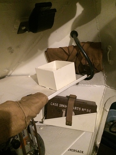

Guys,
Have been making nice progress in acquiring the bits and pieces to stock the interior of the Lynx.
I have not been able to make sense of item #10, Container- Bandolier and Cartridges. I had the original box replicated. The box measures 4" square and is the same as the one in the CWM Lynx. Does anyone know what actually goes in this box ? My second question is, what are the contents of item #12 - Satchel, Signal ? All comments welcomed.
Thanks, Peter

Old 07-12-19, 21:25
Mike Gurr Mike Gurr is offline
Join Date: Dec 2015
Location: Surrey, United Kingdom
Posts: 192

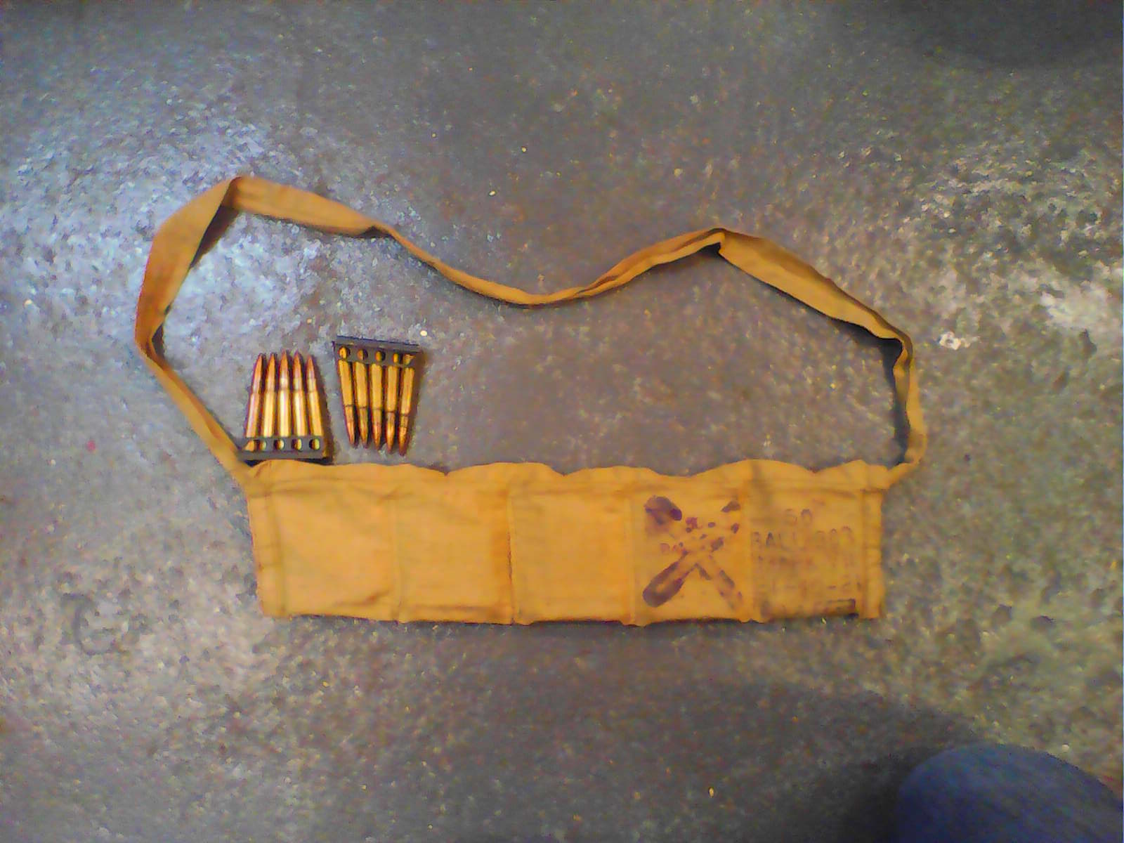

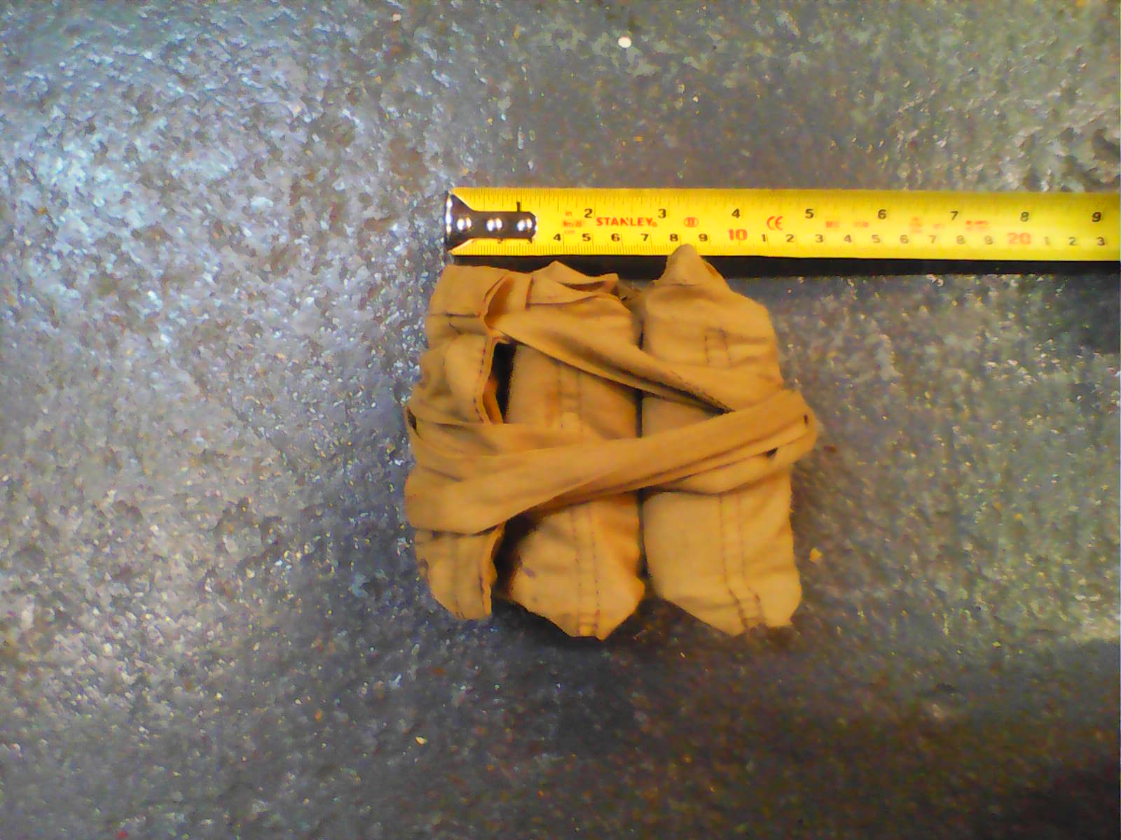

Peter, I am sure the box for bandolier and cartridges would take one 50 round cloth bandolier of .303 I have attached photos of one I have which when folded up measures 4" x 4" x 3 1/2 "
The signal satchel would normally contain such items as the microphone, headphones and morse key for whichever wireless is fitted to the vehicle. As to exactly which items perhaps someone on the wireless forum can help?

Old 07-12-19, 21:51
Posts: 3,660
Hello Peter.
Mike is on the right track regarding the Satchel, Signals.
First thing I would check is the Installation Instructions and Packing List for the 19-Set installation in the Lynx. Usually, the kit will come with enough headsets to equip each vehicle crew member, with spares. A small crew like in the Lynx would probably have two issued sets and just one spare. The spare would definitely go in the Satchel Signals. Not much written in stone beyond that as individual crews would quickly customize the contents of the Satchel Signals for whatever worked best for them.
For example, the Morse Key in a Recce Vehicle like the Lynx, would get a lot of use. It is normally stored, when not in use, in the Spare Parts Case. Not a good idea to leave it plugged into the set. Part way in, it is in ‘receive’, but the plug could get knocked loose, you hit a bump and the key clatters to the floor and finds a difficult spot to retrieve it from.
If the key gets bumped all the way into its socket, and the crew do not notice, the wireless is now in full transmit mode with a constant tone going out to everyone in listening range.
In many vehicles, the spare parts case for the wireless is in a holder, nicely strapped down. Tough to get at when you need the morse key. I would suspect the morse key would be a logical addition to the Satchel Signals for most crew. The satchel would be in an easily accessible spot as needed.
Whatever you decide to stuff in it, Peter, was very likely done, somewhere, at sometime, by a vehicle crew.
Have fun!

Old 08-12-19, 19:05
Join Date: Apr 2011
Location: Cherry Valley, ON
Posts: 554
Default Thanks
Mike,
Thanks for your input, logical and convincing. Now to acquire one of those 50 round cloth bandoliers and have a lid fabricated for the box.
David,
Now to find some more bits for the wireless setup. One item that is not on the stowage list is a flare gun and kit. In my mind it is appropriate kit for a reconnaissance vehicle. Under the parts section there is a "flares in container" which suggests it would be issued. I will take some liberties, which I am convinced the crews did on a frequent basis. In the same vein, I suspect that all the anti gas materials were discarded to provide more space for items that would make life more practical for the crews.
Thanks again, Peter

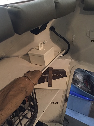

Default More small stuff
Guys,
Andy fabricated a lid for the box on the top shelf that holds the bandolier and rounds. Thanks to Mike Gurr for the convincing logic for how the box was used.
Peter

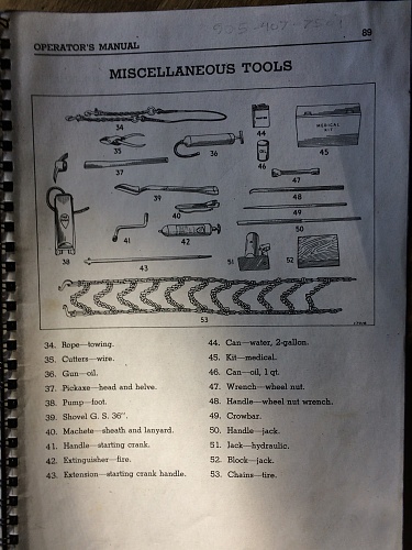

Does any one sell copies of the WS19 Installation Instructions shown above?
Also, what are the dimensions of the tool bag in the tools illustration above?

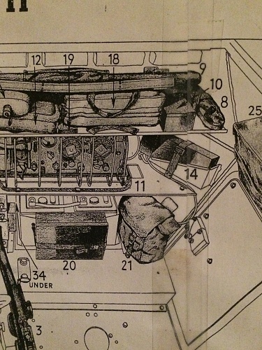

Default Lynx stowage diagram
With reference to Peter's post #791 showing the stowage diagram for the Lynx II, I thought readers might like to see the equivalent for the Lynx I.
The diagram acknowledges that a radio may be fitted (as was the case in all the Lynx I know about) but the diagram shows boxes of bren gun ammunition in its place.
Alastair

Old 06-01-20, 16:23
Posts: 3,660
Interesting, Alastair.
The Lynx I setup is probably a direct, or very close to, match for how the Dingo was equipped.

Join Date: Apr 2011
Posts: 554
Default Thanks
Alastair,
Thanks for posting the stowage diagram for the Lynx 1. My stowage diagram for the Lynx 11 does not have a view of the interior of the front bin. I'm confident that radio equipped Lynx's have a different stowage arrangement but it provides some good hints.
Thanks again, Peter

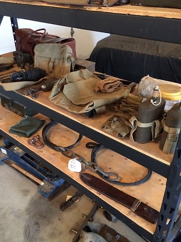

Default Latest

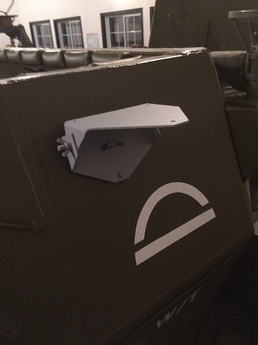

Guys,
While I am confident that my Lynx was never equipped with a sun compass, the brackets that it mounted on were fitted based on all the evidence that I can find. Mine were missing until Alastair Thomas provided me with some great drawings that Andy used to fabricate them. Now primed and mounted. I've also been making some good progress on assembling on gathering the kit, again thanks to some good friends on MLU.
Peter

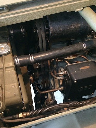

Guys,

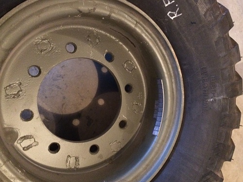

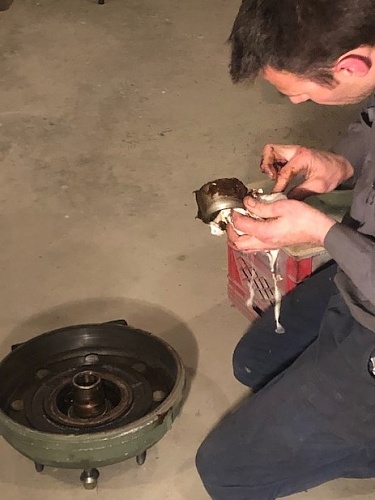

Ever since I had an incident of front wheel shimmy after hitting a bump at speed, I had become uncomfortable on how I had set the front wheel bearings.
With Robin's assistance, I was able to persuade Gerry Foster to visit and reset the front wheel bearings "by the book". Next on my list is to have the wheel assemblies balanced by a heavy truck shop. Now looking forward to this spring's first run.
On a cosmetic note, I was able to source original hose clamps from Early Ford, SC. Took a total of 16, but the engine compartment certainly looks better.
Peter

Bob,
Benson Tire, 61 Enterprise Dr, Belleville. Took two tires there this afternoon. It took me longer to persuade them, than it took to balance the wheels. Done while I waited. Next two for tomorrow. 79$ for the two. The worst wheel/tire took 4 ounces to balance.
I believe that Benson Tire is a chain of stores and I suspect that there is one in the Ottawa area.
Peter

Took 9 ounces on one of mine. I think if the sidewalls were heavier and thicker they wouldn't have needed the balancing.
