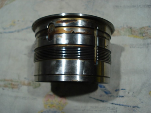

  #73
Old 30-01-20, 05:01
Join Date: Jul 2010
Location: Ontario
Posts: 450
Default R975 rear main bearings

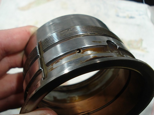

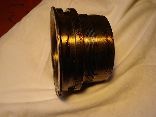

I have included some photos of the 975 rear main bearings. I am looking for some expertise from the forum readers if you can help. Both the C1 and C4 engine use very similar bearings- and while I have a large number of misc bearings the only difference I can see is the addition of the large slot/notch on some of these bearings. Can anyone verify whether C1 and C4 bearings ( which have different parts numbers in the manual) are in fact interchangable? You can clearly see a narrow keyway and the larger notch in the photos.
ID:	111710 Click image for larger version
ID:	111711 Click image for larger version
Just an update... The bearing with both slot and oval notch as shown is for a C1 engine. A bearing with only the slot is for a C4 engine.
A bearing for C1 will apparently fit and work in a C4 engine but a C4, lacking the oval notch, will not work in a C1 engine.
  #74
Old 30-01-20, 16:23
Join Date: Mar 2005
Location: mississauga, Canada
Posts: 1,182
Default Slot
Maybe that large slot on the Wright 975 is an increase in the oil gallery size to get more moving through.
Peter S

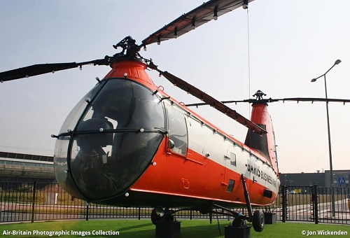

  #75
Old 30-01-20, 21:13
Posts: 14,918

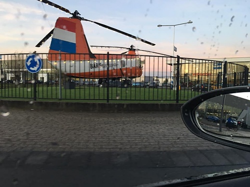

Default HUP - but not of the CMP variant

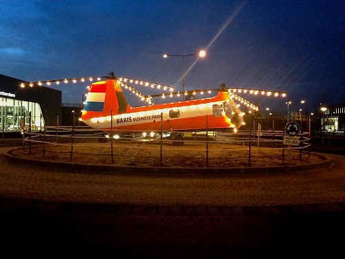

Originally Posted by Dennis Cardy View Post
Bob and David. Here's 246 airborne with 245...Two of only three RCN HUP-3's that Canada bought in the Spring of 1954. Piasecki only built 30 of the HUP-3's. So a pretty rare version. Note only 246 carries Labrador's sort of...kind of ..SeaHorse crest. It would seem from these photo's, that the R-975's were not that reliable. Not exactly sure when or where these photo's were taken. But can only have been a month or two into the voyage. BTW..Good notes about the cooling fan being charged over. The cooling fan has direct implications for AFV installations.
Spotted last December: UH-25B (HUP-2) C/n 253, BuNo 130076. Location: Baris Business Park roadway roundabout in Rotterdam, The Netherlands. This aircraft was originally used by the US Navy and was later transferred to the French Navy. It is owned by Baris since 1973.
(I can post this here - a HUP is a HUP, eh? )
Because of the drive-by nature of my own photo I added some more NMPs for clarity.
ID:	111716 Click image for larger version
  #76
Old 31-01-20, 03:10
Join Date: Jul 2010
Location: Ontario
Posts: 450
I think you make a good point Peter, clearly the large channel around the bearing exterior is an oil channel ( you can see the small holes leading to the interior) so sticking a notch which presumably holds something must restrict or enhance oil flow?? don;t know but at some point will pull a bearing out of a battered crankcase to see.
Hanno, in my book a HUP is a HUP and more importantly in this day and age they have both survived the scrap man! Thanks for the post!
B.P.

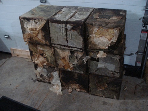

  #77
Old 25-02-20, 03:18
Join Date: Jul 2010
Location: Ontario
Posts: 450
To follow up my last post on rear main bearings I offer a photo of the -46 version, as I have done for most of the other main parts. Note the much heavier flange area. For those not familiar with workings of these engines, the bearing flange sits flush in the crankcase but the projecting threaded portion supports the camshaft.
On another topic, a couple of photos of nine mystery boxes, dug out of storage after almost 70 years...what could they be??
All export packed in waxed cheesecloth over heavy cardboard cartons...
very nice indeed!

  #79
Old 26-02-20, 04:27
Malcolm Towrie Malcolm Towrie is offline
Location: Whitby, Ontario, Canada
Posts: 306
A beautiful sight, indeed! The military packing used back in the day was incredibly good quality.
We had a couple of visitors come by the museum from BAIV, a military restoration company in the Netherlands. When they saw our wrecked Sexton R975 on display, they said the cylinders are going for around 2000 euros each now! So good find.
Malcolm

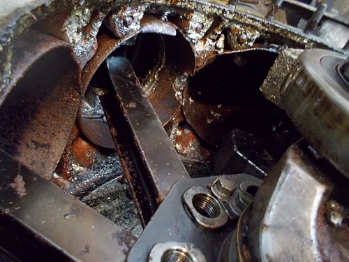

B.P.

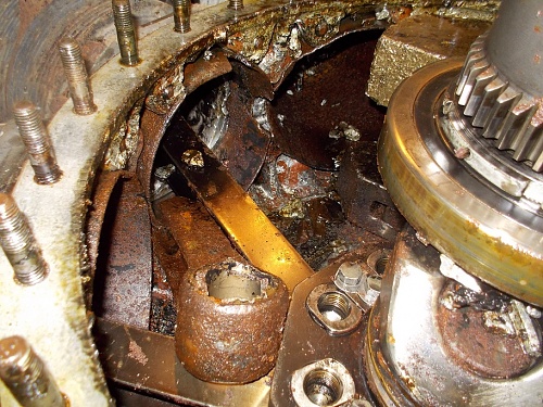

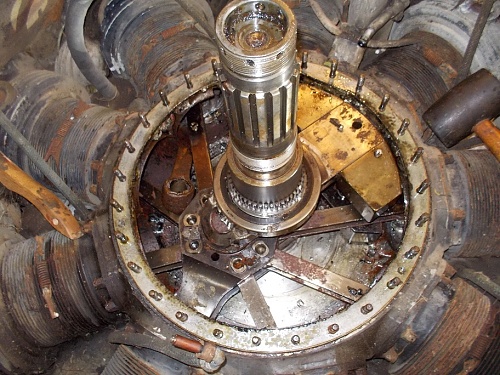

  #81
Old 28-02-20, 21:37
Posts: 306
That carnage looks horribly familiar!
Amazingly, our crankcase looked intact though dye penetrant may have shown some cracks.
And that bell-mouthing of the lower liners as the rods thrash around makes it very difficult to pull the cylinders.
Malcolm

While this engine will provide a few spare parts, I see its future as a coffee table! Not much need to check cracks with this beauty, and, yes it is the worse and most smashed up radial I have ever encountered.

Hi Rob
the sexton engine we rebuilt after Bill got it. It sat in the shop for almost a year before we got all the parts to finish it
It was not a hard job just took time . At the time I had and mechanic that worded for CP AIR help me with it
After the rebuild and break in of about 10 hrs we reinstalled it and put 400 or 500 gallons of fuel through it and it run flawless in the sesquicentennial parade in Kingston in I believe 1985
the biggest problem the engine had to be cranked by hand 52 revolutions of the crank handle before starting with the starter
That is what happened to the engines in the sexton and the grizzly in Shilo
oil compression or hydraulic locks and they scattered or bent a few rods
WHO NEEDS TO READ A MANUAL

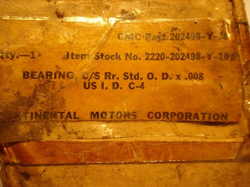

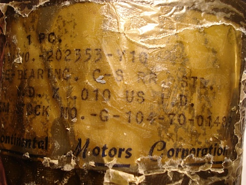

In my earlier post (#73) I put up some pictures of the rear main bearing as used in the C1/C4 engine. I also floated the idea that even though the bearing is separately identified (by part number) for either C1 or C4 engine -perhaps they are/were interchangable. I have not yet pulled a bearing out of a crankcase to check, but I did find a sealed box labelled Continental Motors Corp, with intriguing and slightly contradictory labels, the outside indicating a C4 bearing the inside wrapping indicating a C1 bearing. See the photos.
A case of messed up packaging or strong indication about bearing interchanbability??

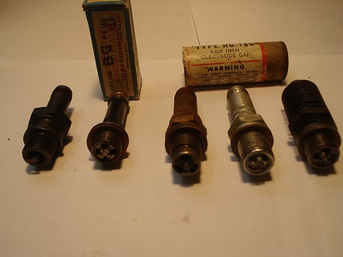

Default R975 sparkplugs

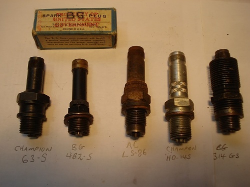

Well while everyone is at home with lots of time to read and ponder, let me introduce the topic of sparkplugs in radial engines. Because most radials were designed as aircraft engines it is not surprising that in the early days tanks radials used aircraft sparkplugs. Aircraft plugs were shielded, had 18mm diameter
short reach (.5 inch) threads and had multiple electrodes ( usually 4). The premium manufacturer of aviation sparkplugs in the USA was the BG Corporation of New York.
These were not run of the mill disposable spark plugs. They were manufactured in two pieces and a well equipped shop had proper fixtures to adjust both the electrodes and the core. There are a number of BG plugs that were used in the 975 engine( and the 5 & 7 cylinder aircraft versions), 4B2S, 314-GS and 417-S. While the BG manual does not say they were suitable for the W670 Continental, it seems that in practical terms they were. (the finned 314-GS was intended for aircraft, not to build the economy version of a C4 !!)
By wars end the Champion 63-S plug was standard in the 975. It was a single electrode conventional plug but retained the shielded connection. See the photos below.
The 975-46 also used an aircraft type plug (AC) and it also used multiple electrodes. Perhaps this style was retained because they were used in helicopters. Note the longer threads on the -46 plug have been cut back to .5 inches so the threads don't foul with carbon (check out the Champion HO-14S beside it).
So anyone tell me why the change? Are multiple electrodes more prone to fouling and failure? Could it be about the cost of the part? All comments appreciated. There must have been vast quantities of the BG plugs made as they are much easier to find today than the Champion 63S.
  #88
Old 14-04-20, 11:05
Posts: 306
Good stuff, Bob. I've always been interested in plug design and behaviour because it causes me so much grief in our fleet of vehicles!
From what I've read, including some good stuff on the NGK website, one reason for the multiple ground electrodes is to reduce electrode erosion because the spark is shared between 2, 3, or 4 electrodes. (Only one electrode sparks per firing stroke.) I see this design is still used in aviation plugs.
I suspect aviation engines have to deal with accelerated erosion because they normally run in the medium to high load range, especially under wartime conditions. These loads require spark voltages in the upper range, maybe 10kv to 20kv, hence more wear.
Maybe that's why the switch to single electrode plugs on tank engines as the load is much more variable so average spark voltage would be less, so less erosion. I wonder if they were hotter plugs too, as i believe fouling was a problem due to longer periods idling than these engines were designed for.
Malcolm
  #89
Old 15-04-20, 03:34
Join Date: Apr 2010
Posts: 1,068
Just from a practical standpoint, how do you adjust the gap on a four electrode plug if you don't have the special tooling. I suspect that this cannot be done in the field therefore necessitating plug replacement.
Thanks Malcolm and David for your thoughts.
I think maybe you have it- aircraft plugs are too difficult to service in the field? seems to make sense. Much of what I have read suggests radials have a bad habit of fouling plugs and need frequent changes of plugs. So this could be due to a too rich mixture at low speeds or too much oil working its way up to the plugs? I have pulled apart engines where the top rings are all seized- probably due to oil leakage toward the combustion chamber. Too much oil will certainly foul the plugs, an ongoing problem in radial type engines.
