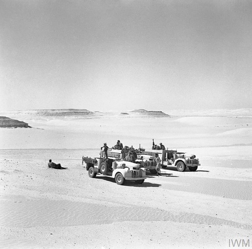

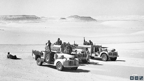

NOT a "pure" LRDG but still very interesting.
Although an Indian pattern with wooden bench seats it does depict a special purpose truck for wide open country....
Some observations...
Flat cowl 1938 or 39 Chev truck probably a 3/4 ton model.....
Nice areo wind screens.
No modification done to the front fenders.
Interesting 6 nut wheels with an additional (x)series of nuts to hold the two part rim together.
Wheel/tires look like they may be 13 inches...?
No visible water expansion tank.
Right Hand Drive.
Cargo box looks very similar construction to the truck on display in the London museum....also looks like wood boards on the box sides....

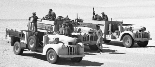

Here's another pic of one of those 15-cwt Chevrolets with Indian Pattern wooden body. It accompanies two 1533X2 30-cwt trucks, so it seems these were used by the LRDG. "Pure" enough for you?
"Object description: Three Long Range Desert Group 30-cwt Chevrolet trucks, surrounded by desert.
Label: LRDG (Long Range Desert Group) Chevrolet 30-cwt trucks, 25 May 1942."
Name:	IWM E 12385.jpg
Name:	IWM (E 12385)_cropped.jpg
ID:	111870 Click image for larger version
Name:	IWM (E 12385)_cropped 2.jpg
Source: https://www.iwm.org.uk/collections/i...ject/205196758

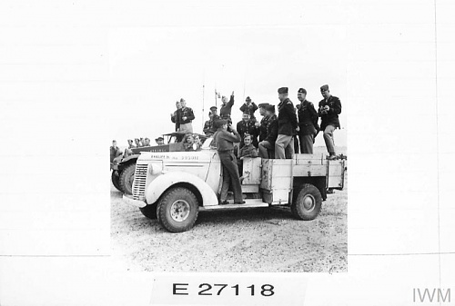

"Object description: General George Patton, C-in-C of the American 7th Army, and General Władysław Anders watching the Carpathian Lancers Regiment exercising, using a M3 Scout Car as a stand (in the background). In the foreground Polish and American officers posing together for a souvenir photograph on the top of a Chevrolet WB 30 cwt truck.. Photograph taken during General Patton's official visit to the 2nd Polish Corps at Qassasin in Egypt."
A further search yielded these were Chevrolet 1311X3 15-cwt 4x2 GS truck (1/2-ton 115" W.B., adapted from the civilian Chevy AK model; X3 = CKD for India). These were used by the LRDG - see the quotes below.
Originally Posted by paul Lincoln View Post
Vehicles seen in photos with wooden bodies were 1311 15cwt trucks used by patrol commanders, medics etc.
Originally Posted by David_Hayward (RIP) View Post
d) I may well be wrong in assuming that the 3-tonners delivered to Egypt under S/M 2005 weer Chassis with cab 1543 Models. I assumed that they were the same as CC60L because of the civilian versions registered in the UK. I can now see the logic in delivering at least the 1940 Models as Model 1541 flat-faced cowl for local bodying and cabs. That said the LRDG 1941 Models included some 1311 1/2 ton 115" chassis with flat-face cowl [as per 1311X3 to India] plus "200" 1533 134 1/2" w.b. chassis with cabs, delivered minus cabs and modified grilles!
Known other Chevrolet MCP trucks include 1/2 ton 115" wheelbase Model 1311X3 for India (and alsdo some for the LRDG), 1421 1-ton chassis with flat-face cowl 125" wheelbase, 1531 2-ton 134 1/2" wheelbase chassis with cab including 200 1533x2 for the LRDG.
From Bart Vanderveen: Truck, 15-cwt, 4x2, GS (Indian), (Chevrolet 1311X3).
6 cyl., 78 bhp, 3F1R, wb 113-1/2 in., 3192 lb.
Troop Carrier based on Canadian-built 1939 (and later) 1/2-ton commercial chassis. Used in Egypt and North Africa by British Indian Army and LRDG. 9.00-13 sand tyres.

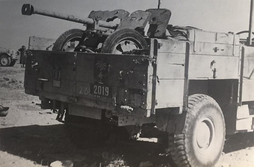

Posts: 14,971
Default Chevrolet 1311X3 15-cwt 4x2 GS truck
AWM Negative Number: 045230. Caption: TROOP CARRIER, 15 CWT LORRY, CHEVROLET, 113 1/2 INCH WHEELBASE. INDIAN ARMY VERSION. LEFT REAR VIEW, REAR CANOPY NOT FITTED.
Here's a picture of a Chevrolet 1311X3 as captured by the German Afrika Korps.

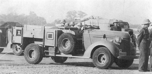

Posts: 14,971
Default Indian Army
One more picture of the Chevrolet 1311X3 15-cwt 4x2 GS truck in use by the Indian Army:

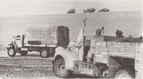

One more picture of the Chevrolet 1311X3 15-cwt 4x2 GS truck in use by the LRDG. They received 25 of these in December 1941 and used them as so-called pilot cars:

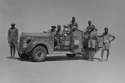

A 1940 model 1311X3 in use by a British Army convoy (not LRDG) on their way back from Kufra returning to Wadi:

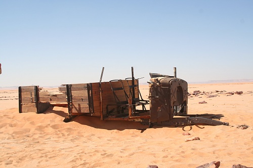

Posts: 14,971
Default Remains of LRDG Chevrolet 1311x3 Patrol Car

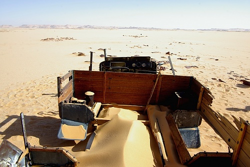

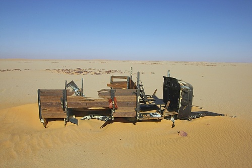

Fliegel Jerzerniczky’s webpage has fascinating stories and photos about his travels in the desert, read more about the The Kufra Convoys here: http://www.fjexpeditions.com/frameset/convoys.htm
He found the remains of one of these Chevrolets:
A short distance south of the previous wreck, there is another one which is not firmly identified. The wooden platform gives it away as a Chevrolet 1311x3 15cwt patrol car, with an added machine gun mount on the front left. A few of this model were used by the LRDG from late 1941 as the early patrol car (alongside the 'standard' 30 cwt 1322x2 which had a full metal body), but also by the SDF as a pilot car for the Convoys. The location of the wreck is very close to where the convoys had to round the dunes to the east of the Gilf Kebir to be able to enter Wadi Wassa, the northern route through the Gilf Kebir, however the easiest route from Cairo to Kufra would have also been along this way. There is no evidence that the SDF pilot cars had mounted machine guns, and there is a good match with photos of the LRDG 1311x3 staff car, making this wreck the only likely candidate for a 'real' LRDG vehicle aside the abandoned LRDG Rhodesia CMP Ford near Ain Dalla.

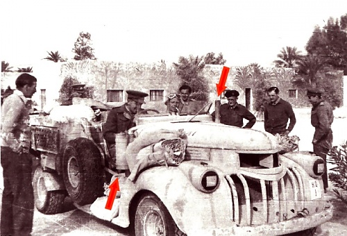

Arrows on first photo point to the diagnostic features: machine gun mount and condenser tank, both modifications standard on LRDG vehicles (but condenser tank was also used by SDF pilot cars, as they were based on the LRDG vehicles). Second photo shows vehicle complete with mounted Vickers machine gun (covered).

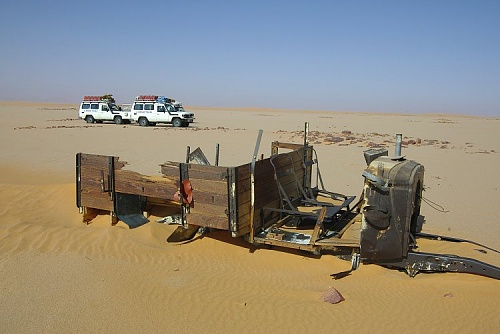

Posts: 14,971
Default More pics of remains of Chevrolet 1311x3 Patrol Car
Fliegel Jerzerniczky’s (...) found the remains of one of these Chevrolets:
Here are to more pictures I found, courtesy of Raouf ElHusseiny on Flickr during his El-Gilf El-Kebir Expedition:

One thing is sure....there are none of the above real LRDG in Canada to copy from........ and right now the lighter "Indian" pattern with the darn wooden box is mighty attractive and would be UNIQUE even if 7 inches longer than the original............
That leaves me at the mercy of what information is collectively available from existing Indian model....and the similarly built Australian NO 1 model.......pictures.... measurements...... etc.
The cargo box looks fairly simple manufacturing construction based on available angle iron or U shaped channel, some flat steel...... and lots of wood.
Has anyone got the pertinent information for the box .....or ever built one?
Would be nice to get the board thickness, width and length .....could get underpinning ideas from the AEBD manual and try a local saw mill for a price quote.....lots of good hard white ash tree wood available as they all died in the last Chinese tree virus....... Once properly soaked with Clear POR 15 they should be almost water tight.....then primed and sand coloured top coat.
