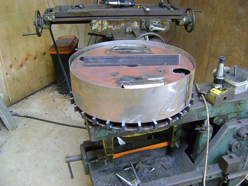

Evening All,
A week of lock down done and I heard on the radio it could last for 13 weeks, so progress will slow right down but it will continue until the materials run out.
I have finished the mould for the drive wheels, it's made on the same principle as the return roller mould but bigger. I am worried that because of the amount of polyurethane required, about 6.5 litres, it will have problems filling from a single pour and although I am loth to use a double pour, I have constructed the mould with two pouring holes.
Jon

Pictures showing how the mould assembles around the wheel hub.
Jon

Jon, can you explain how you mold works please (all the many gaps at the bottom) Thank you in advance.

Yes, still enjoying your build and marveling at your prowess.
Lifting & tilting a 65 pound bucket - interested to see how you overcome that problem.
Maybe rig up a pouring bucket like they have in foundries - a bucket with a pouring lip, hinged within, and suspended suspended from, an inverted 'U' shaped bracket?
I am confused and if I caused the confusion then let me apologise but the weight of the polyurethane is 6.5 litres or 14.5pounds, so where did 65 pounds come from?
Lynn,
The gaps around the bottom of the mould as superfluous to requirements, the vertical pieces of steel that form them, are only there to retain the flat strip that forms the outer face of the tyre in place and at the correct angle. These vertical pieces have been machined at an angle of 5 degrees on their top face which is the correct angle for said face.
The thin metal sheet, that gets wrapped around the mould and forms the outside diameter of the tyre, is held in place by long jubilee clips. One at the bottom of the mould, that seals on the area shown on the picture below (marked with a red arrow) and one at the top the seals around the top cover.
The sealing area is pretty thin but as it has been machined I am confident that it will form a good seal.
I hope that it explains it or at least my theory.
Jon

You can see in this picture the line of the retaining bracket and that the resin has coated both sides.
Thank goodness, success.
Jon.

I thought that before I get too excited and cast all ten, I had better see if they fitted first. They still need fettling but I am pleased with them.
Jon
