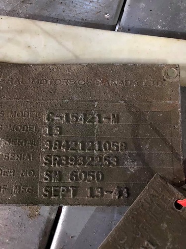

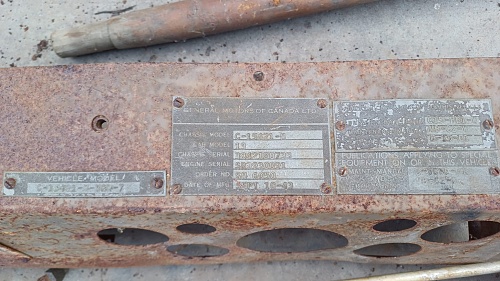

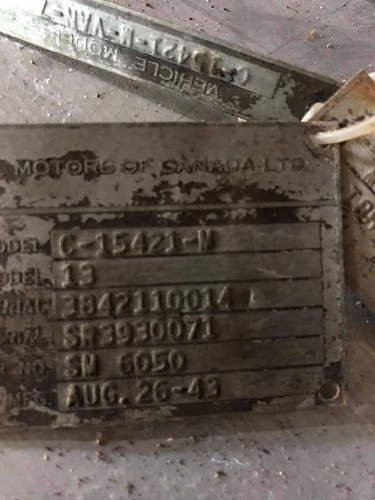

The updated info comes from two data plates sold by Svenn Ry (trucks no longer exist):
s/n 3 8421 10014:
ID:	114001 Click image for larger version

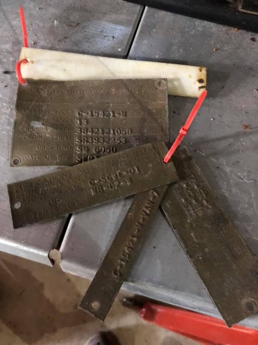

s/n 3 8421 21058:
ID:	114003 Click image for larger version

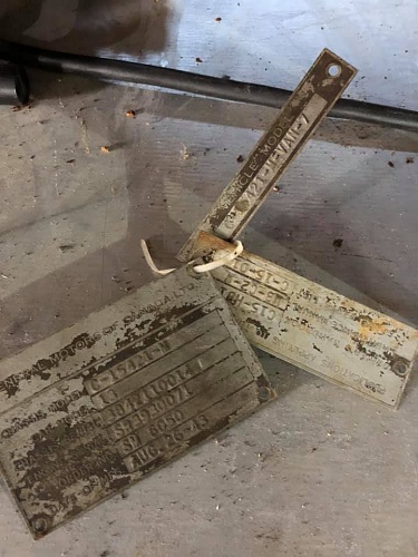

The red line comes from a set of data plates found by Erik Jostad in Norway:
ID:	136136 Click image for larger version
