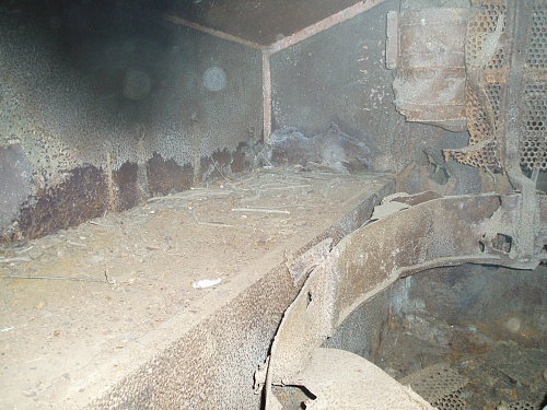

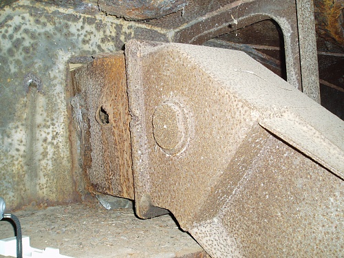

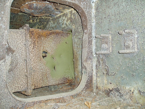

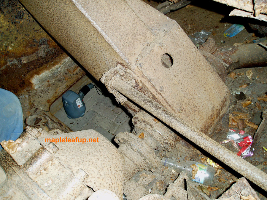

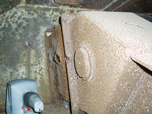

And some pictures of the inside.
I hope you don’t mind me posting these, in which I think the scarring is much easier to see:

The fact that the internal bracing has also bent in that last photo to me points to a projectile rather than a shaped charge striking it. I would more expect it to have simply been gouged out with a shaped charge. It also shows the downward angle: the damage to the brace is slightly below the hole in the hull side.

I wonder how well the lower area of the interior has been cleaned over the years and if any of the things found there were kept by the museum?
Two things can happen with a solid shot round striking armour. At the very least, one hopes the energy transfer is great enough to spall a chunk of inside hull free to fly into the interior to do damage to crew and equipment. As the size and energy behind the round increases, full penetration of the hull will occur and the round itself will bounce around inside the hull, greatly increasing the damage risk to everyone and thing inside, until the energy is spend and the round falls to the floor, spent. Given enough size and energy, of course, the round will pass right through the vehicle struck.
Alex mentions no sign of exit holes on the left side of the hull, so if we are looking at 15 to 20mm round penetrations, and they all came at roughly the same time, there would have been a lot of metal flying around the interior of Avalon for several seconds. Unless lodged in soft metal somewhere, if would eventually fall to the floor.
If the brace on the right side is bent, and relates to the flail drive, could the damage be part of the overall effects of the Crab hitting a mine?
Mine fields typically have set patterns/spacing for maximum effect for a given number of mines. If mines are set in a cluster too close together, hitting one can trigger more in the group. That might have happened with AVALON, breaking the flail and the track on the right side. Depending on why she was at that location during the battle, the crew may have successfully abandoned AVALON. A short while later, a German vehicle arrives on the scene, assumes an active enemy vehicle has been spotted and fires a sweeping burst of cannon fire at it until realizing the Crab is already out of action and moves on.
Another possibility could be mines took the flail out somewhere else. AVALON was on the move to withdraw when she struck another mine that broke her track and she was abandoned.
One other point to consider. There are anti tank mines and anti personnel mines. It is not unusual for infantry to be able to move through an anti tank mine field because not enough weight hits the mine triggers. Leading infantry can walk an anti tank mine field without spotting anything and then wave vehicles through, only to watch as the mines start going off. Be interesting to know if there is enough energy in an anti personnel mine to break a tank track link and cause little other damage. AVALON could have been used to clear any type of mine field in a hurry, not just anti tank, so anything is possible without more detail.
Maybe some answers are still sitting at the bottom of AVALON?
David, when I was in the tank 10 years ago, the lower half of the tank was still filled with all sorts of litter from museum visitors; soda cans, snack packages and the like. I don't think the tank was cleaned all that often.....and they just closed up the hatches (except the escape hatch) to prevent visitors from entering (I am guessing somewhere in the 80's). However, I am sure a lot of stuff in the interior got damaged over the years in the museum from visitors breaking and stealing stuff, but also under influence from weather.
I am not aware of any remaining bits of Avalon in storage in the museum. The engine did get removed somewhere in the 90's/2000's and was in storage until a few years ago. It has since been sold and will hopefully power a restored Firefly soon.
I think both your suggestions on the final minutes of Avalon sound plausible.
I think the brace was either damaged by rounds coming through the sides, or from an internal explosion of ammunition. I don't think damage to the flail itself could result in damage to the brace.
Regarding mine damage; I read somewhere that when the Germans also had a habit of fixing an extra mine or extra explosives to a mine in order to increase the blast disabling flail tanks.

Take a look at the photos of the flail beam in Posts 29 and 32 that you and Jakko added to this thread. Doesn’t it look odd such a large gap to the outside is visible through the right side hull? My gut tells me that gap should not be there.
To my tired eyes, there looks like a shadow outline around the edge of that hole which matches very closely to the heavy metal flange surrounding that beam. I think that flange was originally welded up against the inside of the hull and some external force has broken it free and driven it inwards about 4 or so inches.
If you take a look at the forward side images of that beam, there is a penetration hole with a slightly downward and inward angle. It looks like if that flange was flush with the inner hull, whatever penetrated the hull at that point, also put a notch into the flange beside the entry hole?
That would suggest the penetration hole preceded whatever event broke the beam free and pushed it inwards. It might also mean the large hole in the beam that entered the beam from the rear side and exited the front, may have happened when that part of the beam was still outside the vehicle.

The damaged hull brace mentioned above (just to the rear of the flail drive chain case) is part of the standard Sherman hull and I have no doubt that it was damaged by projectiles that penetrated near it and then hit it. It is not made of armour so would be relatively easily damaged (or repaired again !). The only damage that I see to the flail drive chain case is clearly from projectiles / shrapnel, not from mechanical failure of the drive.
Internal ammunition explosions usually result in the turret being blown off or at the very least a catastrophic fire. I see no evidence of either.
I doubt that an anti personnel mine would break a track but it is certainly not impossible. If an anti tank mine broke the track there would be obvious significant damage to the floor and probably the front bogie.
As for the angle of the penetrations, I doubt that the tank would have been on exactly level ground or at the same level as the gun firing at it. Also if it did loose it's right track before being fired at, the right side of the tank would have dropped as it rolled off the broken track by about 7cm on a hard surface and at least 30cm if the ground was at all soft.

The "flail beam" he refers to is just a casing that encases the flail drive chain that takes the drive from the input shaft flange at the back of the tank transmission to the outside of the RH upper hull. There are no gears involved until the gearbox on the end of the flail drum., just chain drives and the universal jointed shaft on the RH boom. The case has not moved away from the side of the hull. That flange is just the join between the two sections of the case to allow it to be assembled into the hull. The gap between the case and the oversized hole in the hull is because the hole is quite crudely hand cut by oxy-acetylene torch in the side of a complete tank, not in a proper factory setting so was cut oversize to allow some latitude in accuracy. The gap is protected by the armoured box on the outside.
Once a projectile has penetrated the outer hull, it could be going in almost any direction so do not infer anything from where it goes next or the internal damage.

There is indeed a gap between the chain drive case and the hole in the right side of the hull. I know from the crab manual (and I think also from the one Crab in Bovington), that this gap is supposed to be covered with steel blocks/plate, although I am not sure if all Crabs had this, or only later production ones.
The chain box is also fixed on the outside of the hull through springs to an angle iron. This fixation is still present on the Overloon example, so I don't think the gear is pushed inwards. The flange you see in the pictures is a flage to connect to pieces of the chain drive box together, it's not supposed to be flush with the inside of the hull sidewall.
The part of the chain case on the outside of the tank does shows some damage with the rearmost panel bent inwards. I always thought this was a result of the drive shaft snapping, but it could well be that this is indeed damage from projectiles.
Thanks David.....exactly my thought. The story is that Avalon was put out of action by a Panzerfaust that ignited some of the ammunition inside. At least that's the story that is spread on the web and probably also in the museum.
Are you referring to the same brace I was? Because if so, that isn’t related to the flail drive but is a normal structural brace in Shermans, and I meant the bend in it in line with a penetration, which looks like it was made by the round coming through the side.
Some can, but it depends on the type of mine, the type of vehicle and probably exactly where it blows up under the track and wheels. Impossible to tell, I’d say, without knowing all of these variables.
You mean a penetrating projectile whose HE charge detonated, right? Because the interior of this Sherman looks too good for one whose 75 mm ammo had detonated. (Also: there was no 75 mm ammo storage in this area of a Crab, because the rounds went through the opening in the brace, meaning the flail drive chain case was in the way.)

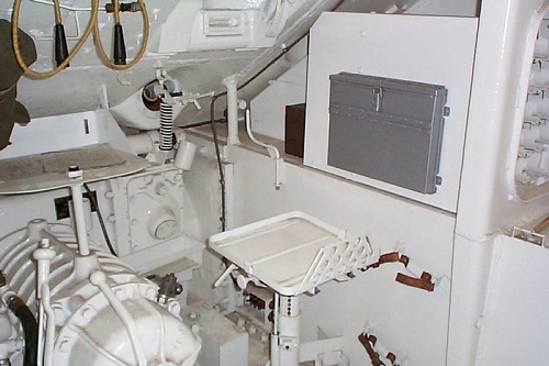

See above: the right front ammo rack had to be removed to make room for the flail drive. Here is the right hull front interior on a restored M4A4:
(source)
The big white box just in front of the brace, with the silver-grey box stuck to its side, is an ammo rack for 75 mm rounds. You can just see the round retention clips through the opening in the brace. This whole rack had to be removed to make room for the flail drive, which goes through a rectangular hole cut in the hull side just in front of that brace.

Thanks for the photo, Jakko. Looks like the co-drivers position was also sacrificed with the flail installation, or got even more cramped than it otherwise was already!
David, I am afraid it was the latter....thankfully he didn't have a .30 cramping the space even more (ball mount was there, but no .30 as it's behind the static part of the flail), but the chain case was right behind the co-drivers seat and above the escape hatch! See the pictures attached.
Also attached is a picture showing the flange in more detail, as mentioned in David Herberts post......and a picture of the 75mm showing damage to the shield.
(source)
That link to photobucket may not show up on all browers. See my web page on Adrian Barrell's M4A4 restoration with interior photos here: http://www.mapleleafup.nl/sherman_sn5271/index.html
The chain case fits behind the seat, just (though that could of course partly be due to my modelling skills, or lack thereof ). As Alex says, at least the bow machine gun was deleted, because the whole flail mechanism and blast shield are in the way.

As David Dunlop mentioned, the gap between the hole in the hull side and the chain case would have allowed vast amounts of dust to be sucked into the tank so I think that the crew would have very quickly plugged it with anything available - I have heard of socks being used to plug bullet holes, making the crew feel much safer as they couldn't see out then. The engine cooling system is designed in such a way that it sucks air from the tank interior through the propeller shaft tunnel and also the oil coolers on the bulkhead, then through the fan and the main radiator, past the engine and out of the back of the tank. This clears gun fumes from inside the tank but if hatches are open there is a huge flow of dusty or cold air into the tank. This can make head out driving quite unpleasant.

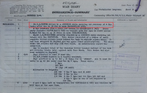

I noticed in your Post 31 you had listed your National Archive file findings for 1944 War Diaries of two of the 79th Armoured Division Regiments, but you had not listed anything for the 1st L and B Horse.
I am not sure if you are aware of this little wrinkle, or not, but even though the 1st Lothians and Border Horse are a Regiment within the British Army, they are in fact, a Scottish Regiment, headquartered in Edinborough. Consequently, it is very likely, their Regimental War Diaries for the Second World War are held at the Scottish National Archives, also in Edinborough. I would start any search for the War Diaries with that Archive.
The Regiment has a very long history and with the name ‘Lothians’ as part of their heritage, it is also quite possible their War Diary records could be held at County level archives, giving you three more possible alternate archive sites: East Lothian, Midlothian and West Lothian in Scotland. In any event the Scottish National Archive should be able to redirect you to the proper source.
One other small wrinkle. Make certain when searching, you use the name ‘1st Lothians and Border Horse’. Over the history of the Regiment, the name switched back and forth several times between, 1st Lothians and Border Horse, and 1st Lothians and Border Yeomanry. And on occasion both names were in use at the same time for two different Regiments, sometimes prefixed ‘1st’ and ‘1st’ and sometimes ‘1st’ and ‘2nd’.
I’m not Alex, but courtesy of Michel Sabarly, I have a PDF of the 1944 war diaries of 1 Lothians. The words Overloon, Boxmeer and Broekhuizen do not appear in it, a quick ⌘F tells me.
Browsing on to 1 October 1944, it says:
0001hrs. Regt, with C Sqn 22 Dgns under comd, under comd 31 Tk Bde, in sp 3rd (Cdn) Inf Div. Located in area SW of Calais as under:
Tac RHQ - 807699 (Beauregard) Main RHQ & RHQ B Ech - 844583 (Boursin)
A Sqn - 812712 (Bonningues) B Sqn - 819563 (Le Wast)
C Sqn - 760650 (Uzelot) C Sqn 22 Dgns - 847583 (Boursin) Reserve detachment of 264SDS under comd RHQ
B Sec 30 Armd Bde OFP under comd RHQ.

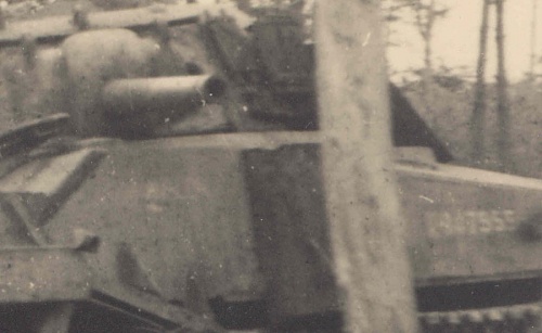

At least two details point to this Crab almost certainly belonging to Westminster Dragoons: firstly, the 79 Armoured Division Formation Sign on the rear is on the right side of the tank, which is a distinctive WD feature; secondly, the name AVALON, if genuine, does not fit the naming patterns of 22 D.
Alex, you mentioned a photo at the Museum showing the name. Did you by any chance copy/photograph it?
Michel

Michel,
I was hoping you would join the discussion! I was just reading your analyses of 22nd Dragoons Crabs in Normandy on ww2talk; very interesting.
Attached is a cutout of the picture I mentioned earlier; I can't show the whole picture, as I don't have the permission to do so. Please let me know what you think....it's hard to read, but I do read "Avalon"....or do I just want to read "Avalon"......?
Thanks for your thoughts on Avalon likely being a Westminster Dragoons tank; I was leaning towards the same thing, but I haven't found the "smoking gun" yet. I have contacted the National Archives for the War Diaries of both Westminster and 22nd Dragoons, but due to the Covid situation things take a bit more time than usual. I was hoping to find the war diaries online, but no luck so far.

Many thanks to Alex for posting the photos with the name. I agree that the name is AVALON. Eventhough the second and third letters are not absolutely clear, what few parts we can see of them leaves not doubt about their being V and A respectively.
I finally found the time to look up the Westminster Dragoons War Diary, and found the following AFV Casualty State as of 30 November, where T147955 is mentioned. This is all the luckier as AFV Cas States are a very rare occurrence in War Diaries. The Westminster Dragoons itself has them for only a couple of months.
This State reads:
A Sqn, T147955, Crab V, X Casualty, located at STOKT 9021, Transmission unserviceable, with the additional note (also applying to 3 other tank casualties) "recovery probably delayed owing to conditions":
Name:	1 - WD War Diary - AFV Cas State 30 Nov 44 - T147955 - Notes.jpg
The War Diary for 30 Nov states that "Cas one CRAB transmission jammed by heavy mine explosion". This Crab belonged to 2 Tp A Sqn:
Name:	2 - WD War Diary 1944 11 23-30 - Notes.jpg
ID:	116599 Click image for larger version
Name:	3 - WD War Diary 1944 11 30.jpg
A previous mention of a new type of damage by Riegelmine 43 mines had been made in the War Diary for 13 Oct regarding the attack on OVERLOON, where it was noted that "All mines in this area were R Mi 43 and not the usual Teller or Holz mine. They had less effect on tracks and bogies but two rotors of C Sqn CRABS were bent by blast. This had not been previously experienced." This explains AVALON's bent rotor.
Name:	4 - WD War Diary 1944 10 08-14 - R Mi43 - two rotors bent - Noed.jpg
On 1 Nov, an attempt was made to recover the tanks, during which Lt GS COOPER was killed by a Schumine. One may presume that this was one of the reasons why AVALON was abandoned rather than recovered, together with the extent of the damage it had suffered:
Name:	5 - WD War Diary 1944 12 01-06 - BROCKHUIZEN 9021 - Notes.jpg
Michel
