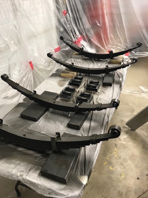

Time for an update. The motor is at the shop for a rebuild, the frame is back from ultrasonic cleaning and the rad and springs are back from servicing. I've pretty much gathered most of what I need to start piecing the frame back together once painting is complete. Surprisingly the front pinion seal was leather and probably original. There's a picture of the frame before and after ultrasonic cleaning which I think did a pretty good job for $150.00 cash and a box of donuts :-). I'll have to do a bit of buffing on the frame before paint and a final degrease as they hit the whole frame with WD-40 after it was cleaned to stop flash rusting

Old 19-11-20, 06:43
Rob Crombie Rob Crombie is offline
Location: Ottawa Area
Posts: 17
Well, you work fast!
I haven’t heard of ultrasonic cleaning an entire frame before. That really did clean up nicely, although I suppose you still have to deal with any rust. I guess if it’s a good way to clean diamond jewelry, it should be fine for a Jeep!
Is this the first time that this has been down to the frame? It looked pretty good at the beginning, so I bet it’s going to be really nice when you’re done.
Out of curiosity, do you know what the issue was with the engine?

Old 30-12-20, 18:18
Peter Phillips Peter Phillips is offline
Join Date: Dec 2015
Location: Cold Lake, Alberta, Canada
Posts: 210
Hard to believe another month has gone by since the last update. Laid down some primer and color on the frame, springs and miscellaneous items. Pressed in some new spring bushings too. Feels good to start bolting stuff back on for once. This was my first foray in using a paint gun and I'm happy with the results for a beginner.
