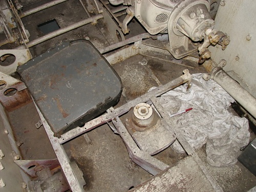

Not much to report on the Panzer front, as I have been busy with other non military projects that I appear to have gained.
As for the Panzer i have been removing the parts that i have previously made and under coating them ready for a top coat as and when.

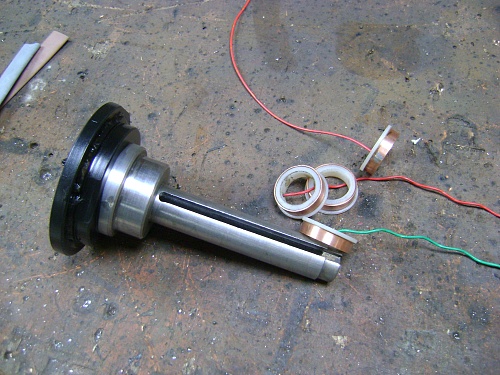

A quite interesting little project that i have finished is the rotary coupling that connects power and audio from the hull up into the turret.
I had thought of using a cheap slip ring as sold on ebay and modifying it to suit but i don't think that it will be man enough, so i decided to knock something up myself.
The rotary junction is bolted to the hull floor and attaches to the leg of the commanders seat, the cables then run inside of the seat support leg and into the turret.
I thought that i had taken loads more pictures but it appears that i didn't. This is the rotor and the copper ring connectors, sorry if my descriptive terms are incorrect but i can't think what the individual components would be called.

The copper is 35mm plumbing tube pressed over nylon insulators with the relevant wires soldered in.
All the external connectors that i have used are clansman but i couldn't find a female socket, so i used a bulkhead fitting and turned up a two part housing that pushes together and sealed it all by covering it with heat shrink.
The outer housing has a bearing top and bottom and an oil seal at the top to stop dirt getting in but i forgot to take a photo of the completed unit.
The whole unit is housed in a fabricated steel enclosure that will be sealed with silicon on final assembly.

The next job is to connect the commanders seat support to the rotary coupling.
Jon

Evening All,
Forward, ever forward and to that end I have completed the support that connects the commanders seat to the rotary coupling on the hull floor. It can't be an exact copy of the original because I have had to modify it to suit my version of the electrical connection contained within.
Now don't laugh, I don't usually show the pigeon poo pictures but I have made an exception, before grinding.
After grinding.
And after painting.

The support is bent in this unusual shape so that it misses the radio operators leg when the turret turns and yes the space is that limited.
That's all for now.
As an after thought, I have Just constructed a lovely pie for tea. A layer of thick cut bacon, followed by a layer of mushrooms, then a layers of chicken, a layer of cranberry sauce, and finally a layer of sausage meat, with a nice thick chicken gravy poured over the top, topped off with nice red Leicester thick crust pastry. Bloody tasty, I can tell thee.
Jon

Evening All,
2021, it doesn't seem five minutes ago that it was 1982 and I was leaving school to enter the big bad world and if someone had told me what a shit year 2020 was going to be I wouldn't have believed them. But forwards, onwards and backwards. On to the turret rotation gearbox and just to remind you what it should look like.
The top section is the actual gearbox, the lower section is just a guard to stop things getting trapped in the gear that meshes with the turret gear ring. This is what the gearbox housing looks like in my world.
13342882_10207592973916419_9155711078906528504_n.jpg   DSC06934.jpg   DSC06936.jpg   DSC06947.jpg

The original unit rotates the turret 4 degrees for every turn of the handle, so that's 90 turns to rotate the turret through 360 degrees, which I find quite hard to believe. I would have thought that there was a fine and course setting but I can't find any evidence of this, however I have read that the gearbox could be disengaged from the turret ring so that the turret could be rotated manually by hand. The original turret ring gearing would have been quite a precise component but of course mine has been fabricated, so I am trying to compensate for this by allowing the gear that meshes with the turret ring gear to have a certain amount of horizontal float. To this end, the internal gears are housed in a frame that rotates around the small forward gear shaft bearings, at the opposite end of the frame will be a spring, that puts pressure onto the frame, thus forcing the final gear and the turret ring gear together, I hope.
It's early days but I think that it will work.
Jon
