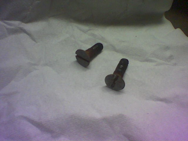

But the BURNING question is where do you find a supllier for the stove bolts......1/4 by 20 that are single slot on the head..... I had to cut, drill, heat up, or chew up quite a few on my truck......
I suspect Rob Clarke will need some and Francesco in Tuscany Italy is also looking for them.....
The nose piece of the Cab 11 which still carried a good portion of the original stove bolts had one small difference...although recessed they had a slightly convex rounded face... and so far I have hit a blank finding them.
I did find a few old NOS Stainless steel at a car show...so I know they do exists...but where....???
Any suggestions guys????
Photo attached is from Francesco from Italy....

If we are talking about same bolts they are readily available here in the states. I bought them by the box at the local hardware store when I did the other trucks. I have to get some for Pattern 12 cab so as soon as I do will post pictures. It they are the correct ones be glad to send you what ever you need.

I followed up on Walde suggestion with Spaenour and found all the stove bolts I can use... in fact he even has them in stainless steel.... which I intend to go for.... if I ever have to remove the nose to do some maintenance they are less likely to rust....
Price quoted for the flat head single slot and also the rounded oval head is $43.00 +- for the steel ones SS will be a bit more.
However, I had to increase my limited vocabulary...caged ntus in Canada are "retainer nuts"..... however they quoted something like $1.35 Canadian each versus the Mac store at 0.60 cents USA.
