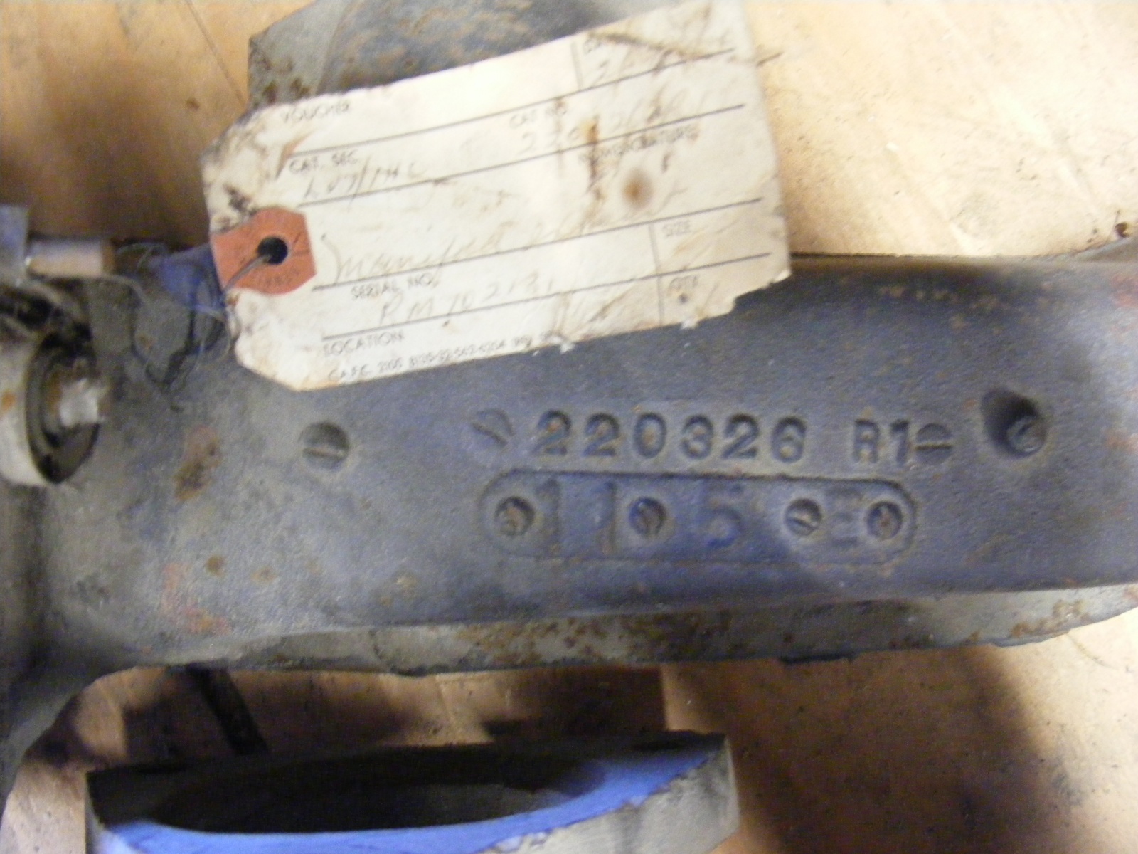

Here is a shot of some manifolds I picked up on the previous trip. I thought they were for the GMC M135, and spent a good half hour trying to get them out of the labyrinth of a shelf they were tucked in to. But they didn't look quite right. Turns out the are, as the tag indicates, for older IHC trucks. When I google the part number 220326R1, it turns out they are desirable to IHC collectors, but I have never had an IHC in my stable. The part number on the tag is LV7/IHC/ 220326R1 .
Oh well, they get to join the rest of the stuff on the shelves, waiting either for the day someone comes looking, or for the auction sale after my demise. It is starting to look like that warehouse where they stash the Holy Grail at the end of that Indiana Jones movie. This was a new and empty shed 3 years ago. Still a little room on some of the shelves yet, so will have to make a couple more trips to the scrapyard this summer.
Bzzzt! Ark of the Covenant.
Chris. (I need a bigger shed, or time to sort stuff and throw old magazines away to make room for radio kit.)
