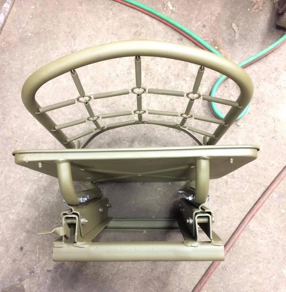

Posts: 4,190
So many parts for 5 seats. But I’m loving the new paint colour. This colour will be used on the Otter as the basic colour. It matches the original very close.

And one can’t forget the 9 rings and 24 springs per seat. Once the springs were mounted I gave them all a quick spray with the paint. The cab seats were also mount to the bases.
