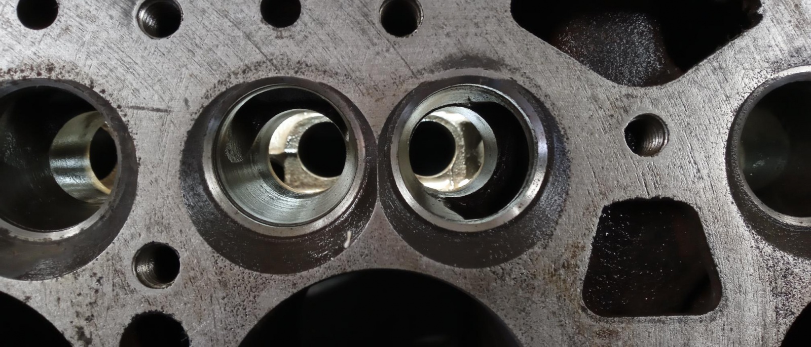

Howdo friends. An apology is owed for my absence since joining the forum! My biggest issue is my restricted availablity of time, combined with accessing the forum Via my phone. The screen is less than forgiving compared with using the laptop at home. That said, all is well, business is steady & my project has certainly commenced. Whilst like many others we await the current global shipping madness to sort itself out, I've purchased a flathead Engine here in the UK to build ready for my MK.I* arrival at some point in the New year? As it turned out it was a golden find. Not only was it in remarkable condition, but on checking the engine number beneath the thick paint, we discovered to our amazement it was indeed out of a Carrier & manufactured around November '43. C81A
I've made an electrolysis cleaning tank at work & to date I've had some amazing results. After only x2 cycles the block now looks like new & absolutely no corrosion remains (especially within the water jackets) Progress is ongoing but I'm delighted with the early results. Please forgive my relative silence from time to time. I'll attempt to upload more photos as I go. Regards to you all.

Great news with the Electrolysis Tank. Other members on here before have used electrolysis on various parts large and small with different chemical recipes, generally with good success.
I think this is the first time we've seen electrolysis for a complete engine block (rather than the more typical passive acid or caustic bath), and it looks like it has worked very well indeed. Could you post more info and pics on what you did and the process you used?

Making an electrolysis cleaning tank. Arm & Hammer Washing Soda was the detergent option as commonly recommended in several YouTube videos. We found a cleaning cycle of upto x20 hours is all that was needed, although I did carry out a longer cycle on the follow up 2nd dip. Around 20A power draw was observed during the initial clean but it dropped significantly across the duration of each cycle. I'm convinced that adding a uniform layout of anodes which covered all areas of the drum definitely paid off. The engine block was supported on wooden blocks in the base of the drum. Core plugs were removed to allow an improved circulatory flow & we occasionally used compressed air through a blow gun aimed directly through the water jackets. Results surpassed expectations.

What strength of Washing Soda? ie Grams to Litres?
And what was your power supply?

In essence, a full drum of water submersing the entire block, I added half a box of the washing powder, no doubt far more than required, but so what, it's very cheap & it's a detergent so it can only be beneficial? I had my heavy duty charger set on 12v low charge, but on initial start it drew a high 20-25amp. This slowly dropped as the hours passed, presumably as the corrosion was removed from the block & attracted to the anode bars the resistance reduced accordingly. By the time I was ready to lift the block & begin jet washing/rinsing, I was unable to increase the power settings which by the end of the cycle had dropped down to about 2amps.
As mentioned before, after x2 cleaning cycles the block looks like new. I'll be doing the crank next which has plenty of surface corrosion to address.
