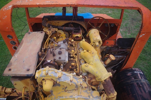

The owner shared a picture of the radiator “in fact it has a hole for a hand crank to pass through the radiator!”
Hanno....it just has to be one, right? The top tank of the radiator seems to have a slightly different shape...and as you say the cap is in a different position. But, I presume there could be details differences between radiator suppliers.
Did the seller share any more pictures? Dataplate? Chassis/engine number?

"Odd Job".
While the roofline and windscreens appear to be of a 13 Cab pattern, it is interesting to note the engine cover and Instrument Binnacle are 12 Cab. You cannot retrofit these to a 13 Cab truck without major work, so the truck has been designed from the start as a real Odd Job.

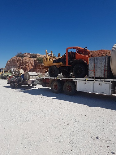

Folks here will be pleased to learn this old girl has finally been rescued from the wilderness and reunited with her CMP family!
Name:	TONY4924 (Custom).JPG

Here she is loaded and ready to depart Mintabie for the 2000 km trek to her new home. Previous owner Peter Liebelt completed the first leg to Adelaide, where she was reloaded for transport to Melbourne.
Unfortunately Peter had axle problems in the middle of nowhere. Fortunately he managed to stop before they became catastrophic.

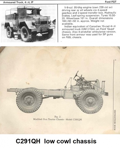

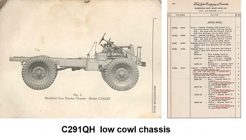

My general understanding of this CMP type, based on the available evidence, is outlined below. It's basically joining the dots between references in various publications, most of which Hanno has previously identified.
The Ford FGT parts list mentions a "low cowl" variant which corresponds with the C291QH chassis described in the Ford Armoured Vehicles Chassis Instruction Book.
Name:	Ford C291QH low cowl chassis.jpg

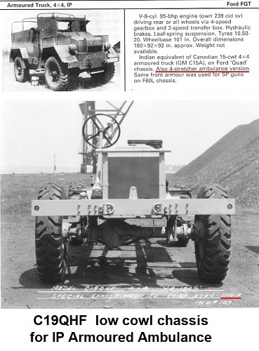

Bart Vanderveen's Historic Military Vehicle Directory lists the Indian Pattern Armoured Truck, and also mentions a 4-berth Ambulance version. These correspond with the C291QH and C19QHF chassis pictured in Ford publications. Given their intended use for armoured vehicles it's reasonable to assume the H-suffix indicates Heavy, but in practical terms the significant feature of these chassis is the low cowl design, achieved by omitting the front crossmember to allow a low mounted radiator.
Name:	C291QH  low cowl chassis for IP Armoured Truck.jpg
ID:	128465 Click image for larger version
Name:	C19QHF  low cowl chassis for IP Armoured Ambulance.jpg

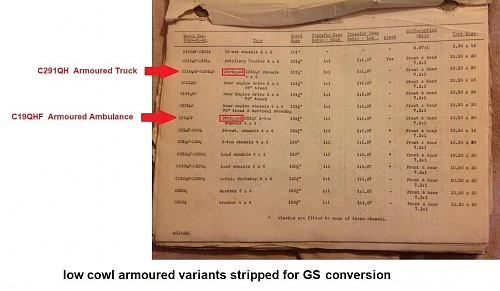

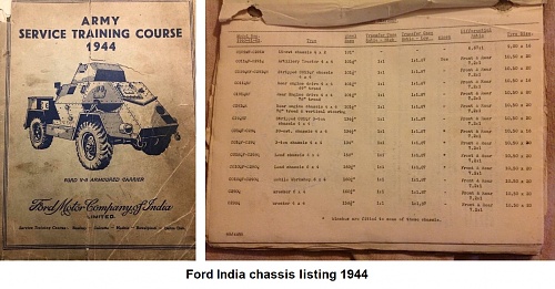

The 1944 Ford India training manual lists the various CMP chassis types in use by Indian Army at the time. It shows the aforementioned C291QH and C19QHF chassis as "stripped", which I take to mean they were stripped of their armoured bodies and converted to GS configuration, using a standard timber rear body. This mirrors what occurred in Australia with the Rover Armoured Car when they became obsolete in 1942. Of course, the Rover AC was built on the standard CMP chassis, allowing a standard cab to be fitted, whereas the Indian Pattern low cowl chassis required a completely revised cab design. I shall post some more detailed pics of the cab structure in due course.
Name:	Ford India Army Training Course manual (Lauren Child UK).jpeg
ID:	128467 Click image for larger version
Name:	Ford India Army Training Course manual chassis listing.jpg
