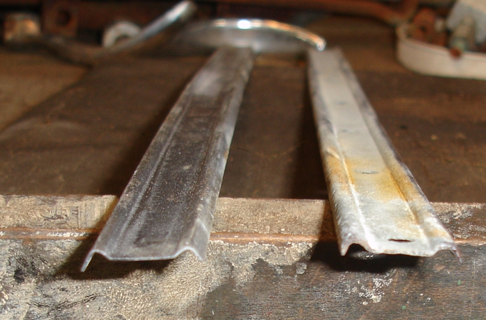

Old 01-07-22, 20:41
Default Roof trim strip
Attached photos of Bob's roof rim strip. I measured the hole spacing on the pictured strip (which is one of the verticals behind the door) as 2-11/16". The measurement was done between adjacent holes and I didn't think to confirm that 5 spaces were actually 5x the individual measurement... The hole spacing on the strip over the doors and across the front of the cab (all one piece) was different (from memory, closer to 3" c-c)

Default Roof strip
That's the strip I'm familiar with Grant and Bob. Thanks for posting the pictures.
Perhaps the trucks assembled in the U.K. had a different type. Like the one on Paul's?
