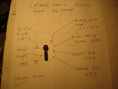

Here are dimensions for crankshaft bolts. If anyone has a source for 5/16 tapered washers please advise otherwise you may have to modify conventional cap screws or custom machine.

There is a company that makes high quality bolts, nuts and studs for performance cars and racing teams, which is also highly sought after by the aftermarket hot rod and muscle car industry:
https://arp-bolts.com/
On page 21 of their catalog (top right of the home page), they list the requirements for custom dimensioned bolts and studs. ARP are NOT hardware priced bolts and fasteners, but they are reasonably priced for the high quality items they are.
https://arpcatalog.com/20/

A drawing of the bolt Bob had supplied dimensions for and an idea for making one from an ASTM F835 bolt. 120K PSI

Thanks Tony for the link to the ARP catalogue. Do they ever make NICE bolts and fasteners. I will try to get a quote from them on the costs of making some crankshaft bolts of the type we have been discussing. Meanwhile just waiting for some capscrews from Mcmaster-Carr to see if something useable can be put together at home. Will share the results when done.

And so, here is the prototype crankshaft bolt in grade 5.
