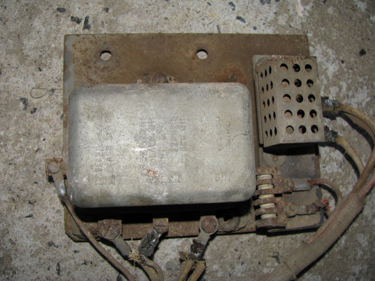

Look VR , one of these are assembly in wrong plate place?
Hi Mariano,
It sure is. The Regulator should be on left side of plate and the resistor and C/B on Right side. Looks like mounting plate was put on backwards on the steering support arm.
