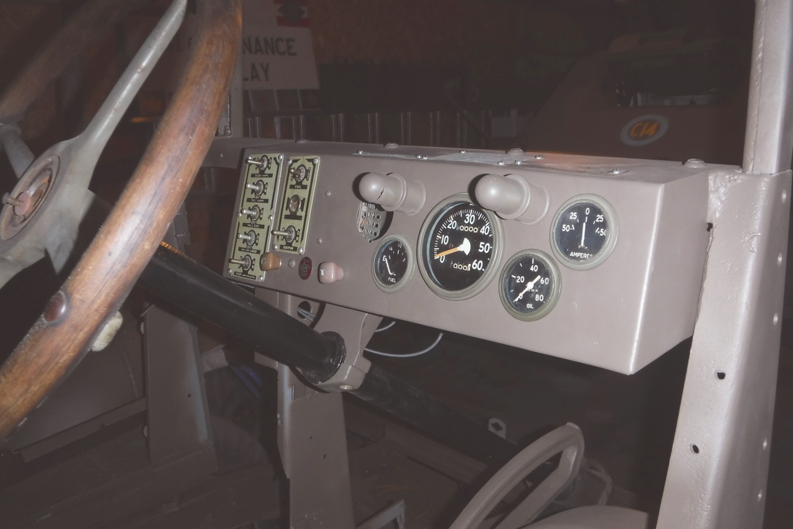

Old 28-05-23, 02:57
I'm doing a hundred and one little things in preparation for ***THE BIG PAINT JOB***
I've already painted the cab interior and engine bay. Because the rear interior is white, the floor brown and the sliding roof hatch a little of each I've been agonizing over the order to paint things and how much masking it will take. Lots, no matter which way I go.
Anyway, after tomorrow the exterior should have 100% of its widgets and be ready for paint, likewise the interior.
I installed the dash finally. The gauges are all correct CMP and the switches/switch plates are original, not reproductions or decals. I shall baby them.... I left the temp gauge out because I don't want to risk damaging its cable during the engine install.
