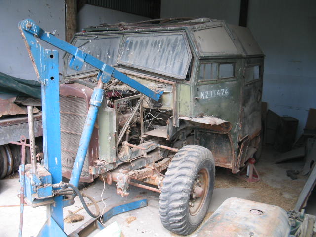

Any comments on these Morrisi survivors? (What IS the plural for Morris?)The first one is a Gun Tractor, with winch:
Old 19-04-05, 01:45
And a Portee version, is it?

I know of around six Morris Commercial 4X4 C8 2 pounder portess here in OZ . All are in a dreadful state with no rear body left . There was one lying in Kilmore wrecking yard just Nth of Melbourne in the late 70's , it was crushed in a scrap metal purge .
Two others were owned by a MV club member here and are reportedly back in Melbourne somewhere . Both are incomplete.
Another three were in NSW owned by a well known collector, all incomplete . One is pictured . The NZ one pictured looks to be a good restoration item . We got no MCC artillery quads though , seems the kiwis got em instead .
Morris Quad project on Trade Me. The seller says it is sitting on a Ford 3 ton truck chassis that is for sale in another auction. Is this rear body the same as a CMP gunTractor?
