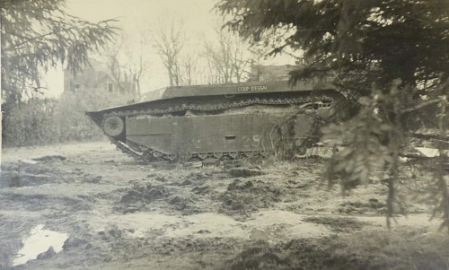

I’ve now found the other photos I have of this LVT:
Name:	LVT Vrouwenpolder 1 (col. J.C. van Winkelen).jpg
ID:	135162Click image for larger version
Name:	LVT Vrouwenpolder 2 (col. J.C. van Winkelen).jpg
These are scans of photos from the collection of local amateur historian J.C. van Winkelen; since he had multiple copies of many photos like these, I suspect some enterprising photographer made and sold them in the 1940s — or perhaps he took the photos himself and printed a bunch of them, of course. On the back of one of these, he had written:
Name:	LVT Vrouwenpolder uitleg (col. J.C. van Winkelen).jpg
That is:—
Vrouwenpolder 1945
(gedeeltelijk door personeel van RAF
gedemonteerd, voor reparatie van
een ander [sic] Buffalo op het dorp)
In English:
Vrouwenpolder 1945
(partially disassembled by RAF personnel,
to repair another Buffalo in the village)
  #252
Old 21-07-23, 22:11
Vrouwenpolder 1945
Great, only I now I notice the second LVT had its top deck lifted off and engine taken out.
Used to repair the first LVT "3B" or was there another one in the village?
  #253
Old 22-07-23, 12:34
Join Date: Apr 2020
Location: Netherlands
Posts: 375
I wish I knew, but the caption on the back of the photo is the only time I’ve ever heard of an LVT having had to be repaired in the field on Walcheren … I doubt they tried to repair 3B, though, since it obviously also didn’t go anywhere when the war moved on. There are more photos of LVTs in this part of Walcheren, though (including one of a number in Veere¹), so these two were clearly not the only ones. I wonder what caused them to be abandoned in the first place.
¹ This picture:
Name:	LVTs in Veere.jpg

Here’s a better version of that photo:
Name:	Coup d'Essai.jpg
With thanks to Ivo from the Polderhuis museum, who came across it on Facebook in a post by one Toon Franken (as I don’t do FB, I can’t provide a link to it).
