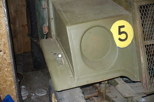

Jerry, speaking as another HUW owner I wonder if a plate on the wing is even correct. From 1942 onwards, the yellow bridge class sign was painted on the right hand headlamp socket cover (only the left side had a headlamp). Later (1944), it was painted on the sheet metal inwards to sit between the headlamp socket and the rad.
I also wonder if '3' is correct. Sure, book correct but other than really early HUP's I've only ever seen '5' as in this wartime factory photo of a 1942 HUP. The same photo series shows '5' on the HUW.

You could always put it like the one on this just pre D-Day pic and keep both headlamps clear. This was the standard place from 1944 onwards and most 1942/43 13 cabs had it there by this time as well. I've never seen a separate bridge class disc on a CMP 13 cab in a wartime photo in the NW Europe theater. There are some early CMP's that had it in Canada but they seem to have been removed very soon after.
Old 04-09-23, 18:36
Photo of an original bridge plate with dimensions (courtesy of grant Bowker) plus one shown in situ (courtesy of Bruce Parker)
