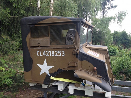

A long time ago, Johan Dieffenbach in Belgium fitted a US K42/K43 body on a C60S chassis:

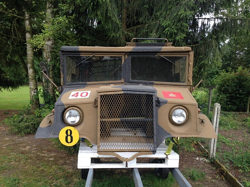

Sometime after 2014, the body was transferred back into the Chevrolet 1.5-ton chassis/cab it came off originally:
