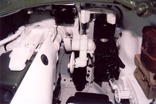

8000 hours. I restored my Sherman from a range wreck to fully restored, including rebuilding the engine in a little over half that.
Compare the result of 8,000 hours of work spent on CT152655 (left) and a little over half that on Adrian's T-146309 (right, and follow this link):
ID:	134958 Click image for larger version
