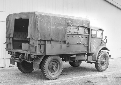

Attached is a picture of a C30 LAAT in Falaise, august 17 1944.

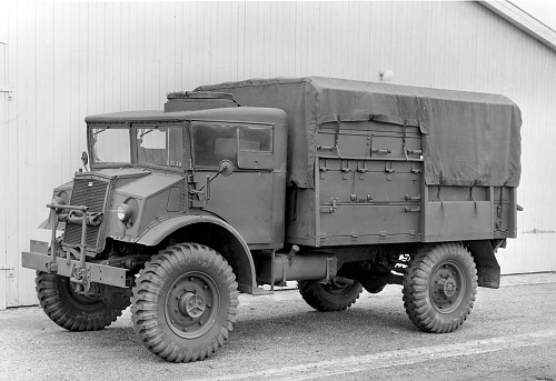

This semi trailer has some unusual features: the winch guide rollers ( fairleads ) and the wheels .
Looked up the ARN and the listing is saying it was originally built as a LAA C60S 40mm gun tractor - the red scribble isn't easy to read, but it seems to have been converted post-war , into a 7 Ton semi trailer prime mover. Tyres are 8.25 x 20. Wheelbase is 134"
