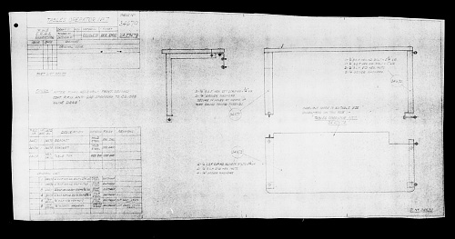

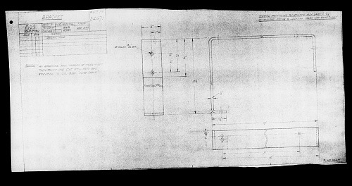

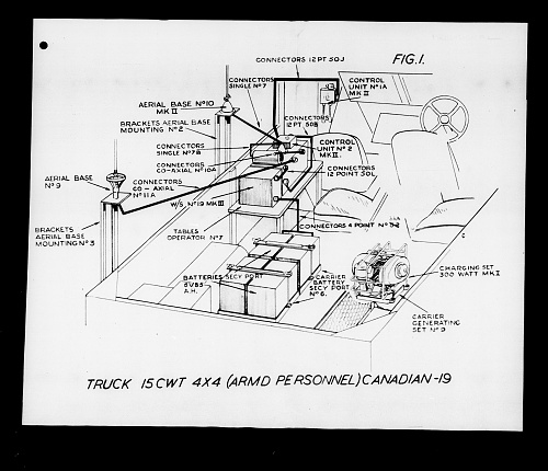

Apologies if this has been posted already.
From online Canadian Archive - Reel C-5819, Page 2912 onwards
ID:	140398 Click image for larger version
ID:	140399 Click image for larger version
ID:	140400 Click image for larger version

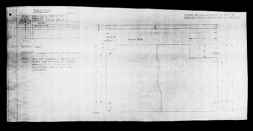

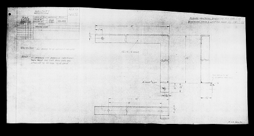

Old 25-04-25, 18:32
Tim Bell's Avatar
Tim Bell Tim Bell is offline
Join Date: Oct 2012
Posts: 805
ID:	140402 Click image for larger version
ID:	140403 Click image for larger version

Tim, thanks very much for this information on the No 7 table. I had planned to use this 19 set installation in my truck but lacking info on the table I was going to use the design that is in Jim Gosling’s C15TA and Jordan Baker’s Otter. They both use slotted 1 ¼ X 1 ¼ angle iron for a top. Jordan kindly provided me with dimensions and I have bought the steel but I will have to re think this now. This flat top table will be a lot easier to fabricate also.

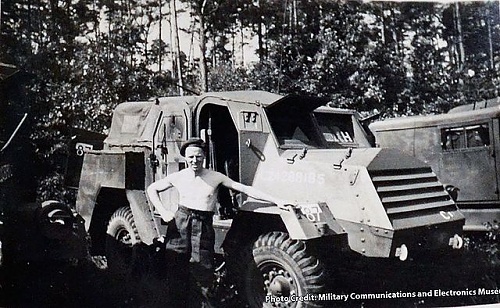

From http://www.rcsigs.ca/index.php/C15TA_Armoured_Truck:
"While the C15TA Armoured Truck was used by units of the Royal Canadian Corps of Signals, it doesn't appear that these were converted to be a principle radio vehicle. The War Diary of "L" Section, 2nd Canadian Divisional Signals records receiving "new 15 Cwt Armoured Cars" in November 1944 and that the one for HQ was to be used as the Brigade Rover."
C15TA Armoured Truck belonging to "K" Section, 2nd Canadian Divisional Signals.
"K" Section supported the 5th Canadian Infantry Brigade. The soldier standing in front is Peter Conroy.
No date or location given, this photo was most likely made during the liberation of The Netherlands.
Source: http://www.rcsigs.ca/index.php/Peter_Conroy_Photos
Credit: Military Communications and Electronics Museum Archives

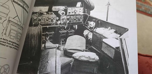

Tony Barron sent me a picture which is in Wireless for the Warrior, volume 2, page 59.
Note the transverse radio setup with two sets side by side:
