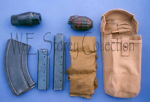

Update on the Thompson SAT information. David mentioned to me he has a 1944 manual that covers the Thompson and Sten. I too have that manual displayed in my collection and interesting enough it only mentions the 20 round magazine. It doesn’t mention the 30 round magazine and no longer mentioned the 50 round drum magazine.
