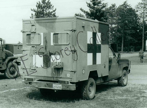

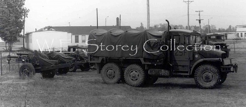

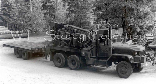

2. Location of Bridge Classification Marking: We don't have a complete frontal photograph of the vehicle in question, so there may well have been a bridge marking painted on the front. However, attached are three images from my archive taken in 1982 that show the bridge classification marking located on the right side of various vehicles. I did not take the time to dig deeper to see if I have anything from the 1970s, but the location of the marking does again appear to conform to DND practices at the time.
