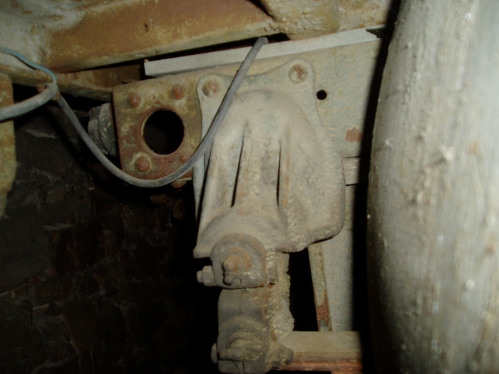

The front spring hangers are waaay different from the earlier HUPs, as they are at the front end of the frame rail and back up a big casting on the inside which is the bumper mount - something else I'm hoping for pics of from Frantisek (hint, hint).
As for "wood" in the rear fender - are you referring to the fender welt? Or am I missing something else?

Default spring holders
HI..
the only photo of a sring holder is this one.. today my father goes to Ivan so I´ll tell him to take more photos.... should we photo any other part of this truck???
FN
P.S.-what wood are you talking abaut?

OK, it's the wood blocks between the body and frame - if they are unique to the 1C11, then I suppose it was part of the redesign to improve the "creature comforts" along with the springs, rubber-mount transfer case, driveshaft brake, cabin liner, heater, extra lighting, etc.
Frantisek - more pictures?? If you can manage it, I would most appreciate a shot of the front bumper mounts - mine were torched off, so I will be needing to fabricate something.
