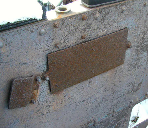

Hi everyone.
Could someone privde me with some dimensions adn perhaps better pictures of the following parts.
First off is the rear seat back cusion.
I know that the two bolt holes are 13" apart CTC. I have scaled out the rectangular part to approx 12 1/4" by 6". Is this correct?
Better yet does someone have an original they would be willing to sell me. That also goes for the flare gun holster bracket.

Old 28-02-06, 06:16
I measured my back seat plate and the rectangular portion measures out to 12" X 6" exactly.
The flare holster bracket shown in the photo is missing it's grease nipple. The grease gun's hose would run up to the bracket where the alemite adapter would hook on to the dummy nipple. This was likely so the radio operator would get grease on his uniform and get the kitchen duties, leaving the driver free on weekends.
Old 28-02-06, 06:30
Posts: 4,190
Hi Rob
Thanks for the dimensions. I guess I was pretty close. What thickness of sheet metal was the rear seatback plate.
In the parts manual it lists wood screws (31873 S) that are #8 csk head by 1/2" long. I have seen another carrier that had a wooden piece (CTL 13172?) the same dimentions as the backrest. I would then assume that the wood was porbably plywood and it was 1/2 thick. Would the vinyl material (Tl/CTL 13173) simply be wraped around the wood and padding (TL/CTL 13174) and then stapled?
Question. Why would there be a grease nipple on the flare gun bracket other then for getting grease on the radio ops backside?
Old 28-02-06, 16:25
The metal plate I have, which is an origional, measures about .140 thick. I don't recall the thickness of the plywood piece, but by those screw lengths, it would have to be at least 1/2", and possibly 5/8" thick.
If I recall correctly, the back seat cushion was not merely stapled to the wood (that would be too simple). It was of the same design as the front seat backrests, with the little lift the dot snaps and studs. I think Brian Asbury had these at one time. Somewhere in my junkbins I think I have a (shrunken) origional.
The grease nipple is just another example of the British armys newfound battledrill. There was a place for everything, and quite often a precise way of using it too. In the manual "The carrier platoon" it even details how to get into the carrier (ie: plece left hand on armour, left foot onto top of track, swing right foot over......) and gives a time limit as to how long it should take.
The grease gun bracket was located on top of the gastank, and the hose would run from the end of the grease gun, up to that bracket. I guess that was better for the hose than curling it around under the seat.

Old 13-04-06, 05:55
Posts: 4,190
Just took this pic yesterday on an unrestored carrier about 20 min from me.
Showing the seat back with wood (original?) and the flare gun bracket with the grease nipple.
Old 13-04-06, 06:04
BIG MIKE
Guest
Posts: n/a
Jordan,why does the flare gun attachment have a grease nipple?. BIG MIKE
Old 13-04-06, 06:07
Posts: 4,190
Read ^ up ^ three posts above yours
