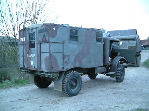

Does anyone have any pictures of the interior of a chev C30 wireless truck or any info on the equipment it carried.

Martin:
I could be dead wrong, but what you've shown seems to me to be a 15 cwt wireless box (which would be fitted on the 101" WB chassis) mounted on the 158" WB chassis.
Going through, for example, Canada's Fighting Vehicles, CMP Series Vol I, I couldn't find a match for the configuration which you posted.
Perhaps a review, if possible, of the history of this vehicle might uncover some relevant facts about probable matches of chassis and superstructure.

Hi Guys
This is a 30cwt body and is very similar to that fitted on a 15cwt but the body is that bit longer and leaves enough room for the wheel carrier behind the cab.
I guess the interior would be very simi lar to that of the 15cwt

Hello david
Regarding cdlv314 for a wireless this truck had a breakdown body formed by cutting down a wooden radio body as on page 98 bill greggs book all the floor beams were numbered with yello paint but it was early days for us so through the lot away including the rear steel mudguards i can see why they were called house type vic eaton
Old 01-09-03, 19:36
Vic Eaton Vic Eaton is offline
Location: England
Posts: 250
Hello bruce
here are some differances i have noticed between a 15 cwt and a 30 cwt radio body
c 15A rear ladder ends at roof hight
no rear body heater behind cab
total lengh of rear body 7 feet
3 roof vents one power driven
C 30 Ladder continues above roof hight forming hand rails
Total length of rear body is 9 feet
4 roof vents all manual
All steel body
The rear body heater is the part i would love to findit was an evenair vehicle heater model 204212 SER B11556 We have the instruction plate for lighting it had two fans one for forced air to the burner the other for circulation i expect its in someones
green house somewhere vic eaton

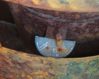

Was checking a little on the wireless this afternon. The heater is -not- attached to the wheel carrier. It is entierly hold on place by bolts to the body. The serial # on it is B-11576 and Model # is 204212
How the burner works, is a bit to much to list here, but Vic if you give me your snail mail, I can send you a copy of a Manual called "Artic Equipment for Canadian Military Pattern Vehicles" (RTCI-C1) of July 1942. It has a section among several, regarding the "Gasoline Body Heaters" for "30-cwt Wireless Body: 3 Ton 4x4 Ambulance and Office Body". There all about the heater is.
Rolf

There is a small round "thing" in the passangers rear corner of the cab. Have put in a picture. Any idea what that might be??
Rolf

Hi Rolf,
Just got back from a few days holiday.
That round thing you have in your cab is as a buzzer that was operated by people in the wireless body, we also have this in one of our wireless trucks.
It looks like Dad is getting into this forum stuff!
