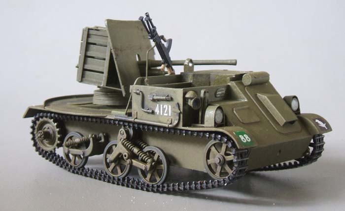

here is my 1/35 scale model of a 2lb anti tank carrier.
I used the Tamiya carrier kits bogies, tracks & lower hull the rest is scratch built. Gun is a modified Sovereign 2000 resin kit. Formation & unit decals are home made with the white numbers being Archer dry decals. Numbers and unit markings are ficticious and for representation purposes only.
I have made a couple of mistakes but am overall pleased with the result.
Cliff

You could almost hop in and drive it!
Congratulations, Cliff what a great job you've done, and a unique model to boot.

Mate that's a fantastic job, especially as you couldn't just go out and have a look at one. As you said there are some very minor inaccuracies but shit, I don't reckon that I could do better and I can go have a look at one in the flesh.
Once again, bloody top effort mate.

I paid for a resicast set but was ripped off by the Canadian seller and this is why I used the Tamiya rubber band tracks. An English friend sent me a spare length of track so I could do the longer tracks as the attack carrier is 5mm longer then standard at 1/35 scale.
Thanks for the comments guys I really appreciate them.

Beautiful model as always, however your Hull Number is incorrect. The 2pdr Anti-Tank Carriers were sequentially numbered from #6000 to #6200. #4121 was designated to a 2A produced by Ford under Order No. CCN.62 as was the Jacques Littlefields Carrier if that purports to be an Aussie Carrier.

Apparently Jacques Littlefields carrier was sold to him by Mr J Swan. I was told that the hull number is slightly mixed up. currently reads 4086 but it should read 6084.
This better fits with what we know about 2Pdr hull numbers.

Bob is correct, all the 2 Pdr Carriers started with the series number six and the other three digits were the ARN (serial or hull number). Giving you a four digit number 6XXX. The hull number was also stamped into the tow coupling at the front centre of the vehicle with stamps about 3/4 inches high. Gives you a place to look if you don't have the ID plate.

Bob thanks for that but I did say in my first post that
Mind you had I realised they started with a six I would have made a six the first digit. The numbers were cut out of a set of US Army numbers made by Archer Transfers.
