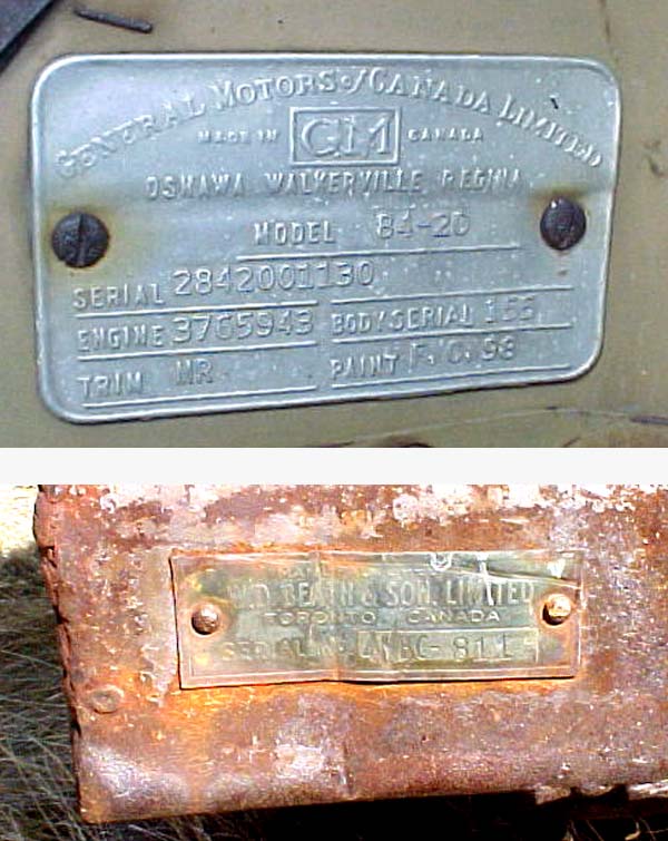

Here's the data plates off that 12 cab C8 with 1B1 body in Alberta. This is the truck with the top bows. The floor of the box doesn't have any holes drilled in it so maybe it's one of the GS models that have been mentioned. A personnel or wireless truck would have had seats bolted to the floor.

David, these are the 1942 Models known to me:
2842001130 ENGINE # MR3,765,943
2842001192 ENGINE # WR3,765,985
2842001330 ENGINE # WR3,766,091
2842001378
2842001395
2842001422
2842001427
2842001497
Then it is believed that Number 13 Cab production commenced at 284XX01524. This might suggest that C8 production ran to 2842001523 [unless anyone has seen a #13 C8?], and then when did they start? Possibly shortly after 001053. Evidence: known 1942 C15A production anteceding C8, then C30 and then C60S, with 2844201052 being the last known C60S before the C8 batch.
Production ended according to DND papers I have seen in the past in "Late 1941". I have been looking at various data and concluded that the C8s were all built in one batch. However I may well be wrong. Here are three data plates:
GENERAL MOTORS OF CANADA
MADE IN GM CANADA
OSHAWA WALKERVILLE REGINA
MODEL 84-20
SERIAL 2842001130
ENGINE 3765943 BODY SERIAL 155
TRIM MR PAINT F.C.98
MADE IN GM CANADA
MODEL 84-20
SERIAL 2842001330
ENGINE 3766091 BODY SERIAL 300
TRIM WR PAINT F.C.98
MADE IN GM CANADA
MODEL 84-20
SERIAL 2842001192
ENGINE 3765985 BODY SERIAL 435
Note the body serials do not conform with chassis numbers suggesting that there was a large number of chassis-cabs all lined up and they were then allocated bodies in no order as received. However we can see that there may have been 450 or so chassis.
As to dates, late 1941 might be correct as regards orders to terminate production of chassis. I have been trying to make sense out of the engine numbers and correlating them with other known CMPs where assembly dates are known. My best guesstimate is December 1941 at this juncture, though it could have been early in 1942, but 1942 Models. I think GM of Canada had secided to change the Model Year system for 1942 as it was causing confusion, with MY numbers being allocated to indicate when contracts had been placed. That is why we have 1940 Models being built into 1941 Calendar Year for the Canadian DND at the same time that 1941 Models were being assembled for the British Ministry of Supply. I have the 1940-41 Ford of Canada engine number runs per month and assume that something simialr occurred with them but for 1942 MY production they would have resolved the anachronistic system.
The easiest way to check GM of C production dates before assembly dates were added around 1943, is if the original engine is there, or if the replacement is approximately the same number as the engine installed. On the block is a casting date code, and we can then determine when McKinnons cast the block in St Catherines, Ontario. We must then add say two weeks for Windsor Transmission Plant to build the engine, and then add more time for the engine to reach Oshawa. We know monthly engine production at Windsor so we could establish roughly when an engine was assembled and then add on say up to four weeks for the engine to be installed in a chassis. After that you must add time for the chassis to be railed or roaded to the body-builders of course unless C8A HUPs where Oshawa built the bodies.
I would suggest that Ford of Canada in Windsor had a similar timescale and used casting date codes except that the foundry was more-or-less on site in East Windsor/Ford City as the assembly plant so you could trim some dayes off the foundry-assembly time. However as mentioned previously we know the 1940-41 Ford series and the "2G-" Mercury engines as used in the CMPs continued on until sometime in November 1941, some weeks after other 1941 engines had finished. I would then imagine that 1942 Model Year production commenced December 1941. This would seem to fit in with what Oshawa were doing.

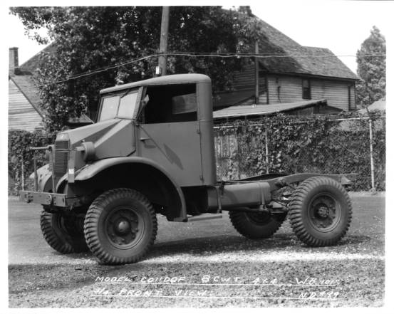

Bit of both...late April Fool, mental abherration and cross-wiring with the F8A # 12 Cab! Sorry about that...too many balls juggling in the air to remember every detail. Of course the C8A was prototyped with a #13 Cab and it was only the F8A that had a #12 Cab. The later order for India must have had # 13 Cabs.
Compare these photos.
  #82
Old 04-04-07, 15:56
David_Hayward (RIP)'s Avatar
former Resident Historian
Posts: 3,841
Default Photo 2
Does this prove the point about the cabs and boards? I have often thought that Ford "had a go" at the concept of a 8-cwt 4 x 4 but for some reason not stated in writing that I found yet, GM of Canada took up the cudgel excepting the Indian order. I am guessing that:
1. Ford of India wanted chassis-cabs only for local bodies
2. Ford did not want the hassle of building complete HUPs ir may not have had the body-building facilities, and thus the capacity
3. The DND favoured GM of Canada, just as they did with the C60X over the F60H V-12 and proposed "F-60X".

21758 ? ? ? ?
21825 2G 49525F 11/13/41 CD 384 long box WIRE
* list actually says 25586 but I think that must ba a mistake
All of the above were listed in Canada in 1988.
