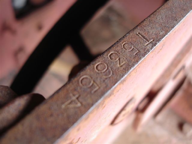

Could anybody shed some light on the history of this carrier please. Where it was built in Canada etc , how many were purchase by the NZ government, when they were shipped ? On the top of the drivers armour plate is stamped its part number T5365, as well as 1942 FORD 5934, There are also small + and ^ type markings, any info would be greatly apopreciated, Thanks David...

So that Nigel can give you the details for the right carrier,you have missed a digit from the "T" number (even though its stamped 90 degrees out)
This is the registration number that will be painted on the sides.

As I cant post pic at the mo. the T number is T53654
Hi guys
T53654 was a Universal Carrier MkI* made by Ford of Canada to order WSL72.2. It was one of 3,400 produced to that order. I am unable to ascertain what the WSL72.2 Contract No. stood for as nearly all the orders placed with Ford Canada were S/M or CDLV numbers except those for New Zealand NZ and Australia A. Someone will know.

Heres the picture I took at David's last weekend

Before anyone gives themselves a heart flutter seeing that last photo of the T number and thought could this be T 5365 and the 4 being April making it a Scout MkI carrier.......it's not! The Scout with this number was made by Aveling Barford of roller fame (no not the baycity ones!). So sorry my first post re the number is it!
