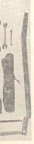

In Nigel Watsons book on Carriers he has some info on the crew stowage locker. Specificaly Im looking for anymore info on the webbing attached to the inside of the lid. Does anyone have some clear pictures as to what this looks like?
The picture of the tool pouche on the underside of the Stowage Locker was taken at Bordon when I visited way back on their MkI* carrier. I am told that it is no longer there (the pouche that is). Can anyone confirm this? I know the carrier was due to be restored a bit so maybe it was just taken off before that.

Thanks Nigel for the info. Did you have any other pictures of it then what was in your book?
Does anyone know if it would have been the same size as one of the pouches on the bren spare barrel bag?

Finaly made the trek down the road from me to get some pictures of this very elusive part. Its the little canvas bag/cover that is attached to the underside of the crew stowage locker.
Ive got a basic set of drawings done up and will be making a pattern over the next few days or so.

The original application ( pre universal) of this box, was for spares for the bren. The clip inside the lid is for a cleaning rod. I have the canvas pouch, but as with the metal bkt. in the corner, I dont know what they held.
I have two drawings, both identifying it as "Case, spare parts for bren"

I had originaly thought that the canvas flaps would hold the Bren spare parts wallet. However now that I have the dimentions the flaps are way to small.
Going from my first photo L to R Ive got some ideas now of what might possibly fit. The pocket would fit a standard oil bottle, the midsection is actually a small pocket with the opening on the RS, Im thinking the small parts tin would go there. As for the big flap, its 7" x 7.5", Im wondering if a cloth would go there. When the flap is done up the ends of it are open and I can't see any "hard" object staying put in it.

I also saw diagrams etc. designating it as "bren gun spares" And in my box I also have 2 clips that hold a bren gun cleaning rod perfectly.

Great thread and I am glad I looked at it. I had that canvas thing included with my carrier when I bought it. I had no idea it related to the carrier, I thought it was just something the previous owner had thrown in. Glad I didn't toss it.

i'm fitting a stowage box to my carrier at the moment and it too has the canvas and other small fittings inside. did anyone figure out what the oil can holder looking thing in the corner was used for?

No Rick, but the 1941 U.C.Mk1* parts book states:
"TL 12207 Case-tool,Bren gun, canvas"
That's all the info I have.
