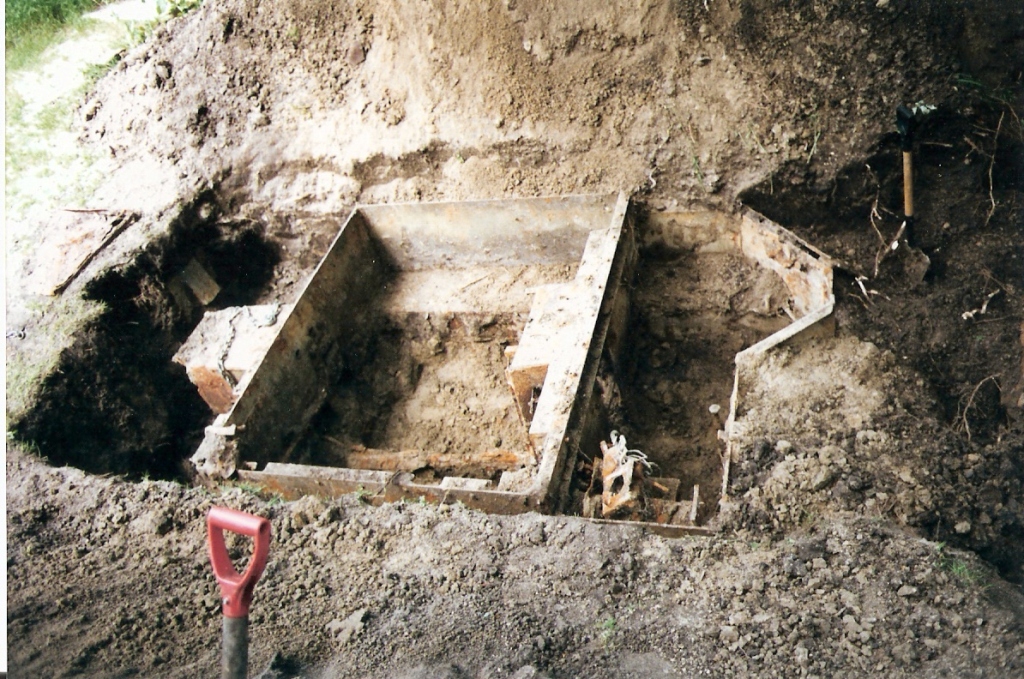

Dave,
The carriers in the picture were dug up in June of 1998.The first 2 were the year before and the 5th carrier was the year later.
The valve and tube you were asking about is to drain the block.The brass valves were on both sides and the tube had a little funnel underneath the valve which shaped into a Y and drained down to an opening in the bottom of the hull.Here is a picture of your carrier in it's grave,this is the No #4 carrier,you can see in the mud behind the No #4 carrier,the plate of the 5th carrier;
And this is the no #5 carrier;
