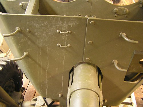

Rob, as I said in the other thread, 6 pdrs can have two lengths of rope hooks. The shorter ones are not long enough to take a 25pdr rope, hence the reason I started that thread.
Most guns seem to have the shorter hooks as do the later auxiliary shields. I suspect the no2 ropes were 30' long in 2" rope (5/8" dia.).

My thoughts are that the longer rope stowage hooks on a 6 pdr shield would suit the thicker rope, but not at the full length of 30' for two thick ropes. Has Marc's gun got the short or long hooks? One long rope = 2 short ropes

Firstly, a standard 25 pdr rope on a pair of the short hooks on my gun. Incidentally, one of the other guns I have here has slightly shorter hooks but they are both considerably shorter than the long ones seen in some period pictures.
Whilst it is possible to fit the rope, it does not leave enough room to fit another on the second pair of hooks. The longer hooks seem able to take a 3" rope.
Adrian Barrell

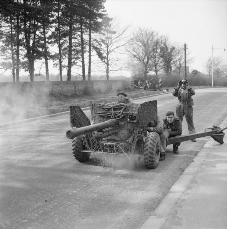

Most wartime pictures that show anything generally have one rope per pair of hooks. The manual has no information of any use.
I wouldn't take the Firepower example as indicative of anything myself.
