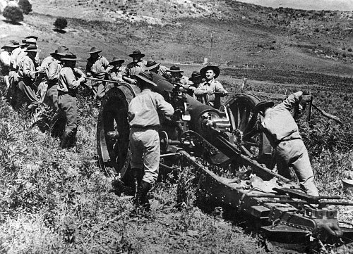

Hello All,
With the mention of moving 25 pounders, my grandfather was in the 2/1st Pioneers and it is reported that ...."after two days in Port Moresby, A, B, and C Companies moved to Owers’ Corner at the base of the Kokoda Trail and up the track through Uberi to Ioribaiwa. The battalion patrolled and manned defensive positions along Imita Ridge and helped the 14th Field Regiment move their 25-pounder guns up the track to the foot of Imita Ridge". (Accessed February 28, 2017 from: https://www.awm.gov.au/unit/U56185
So I suppose there was the odd trick learned about how to get them up a mountain side.
Photographs sourced from the Australian War Memorial - Accessed Tuesday, 28 February 2017 from:
https://www.awm.gov.au/collection/027024;
https://www.awm.gov.au/collection/P02424.024; and https://www.awm.gov.au/collection/P02424.004
Kind Regards
Lionel

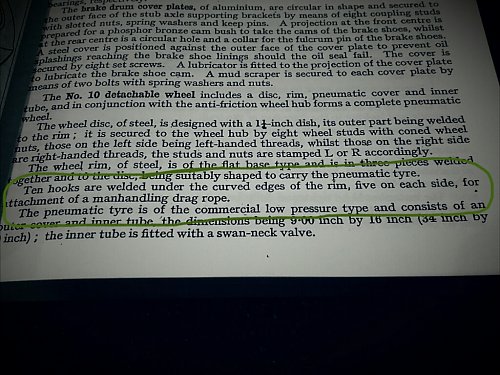

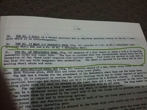

Old 28-02-17, 11:07
Hopefully more detailed than these entries.
Name:	2017-02-28 19.02.01-resized-1024.jpg
ID:	88877 Click image for larger version
Name:	2017-02-28 19.00.58-resized-1024.jpg
Complete bollock, so far as useful information goes.
And it took two different manuals to tell so little.

This photo taken from the Internet. British ww2 or Korea, 5.5" gun I believe.
Old 28-02-17, 13:05
Posts: 7,621
Excellent photo Andrew, thanks, and certainly supports my theory on how the ropes were attached.
If there ws ever a need for mechanical advantage, pulling a 5.5" over rough ground would be it.
