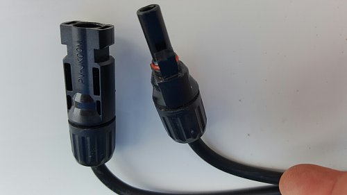

My panel has retained the correct connections needed for proper external installation. Some folks cut these off, in their frenzy to get them off the roof.

A suitable solar regulator/charger was purchased a week ago. The required connecting cables between PV panel, regulator/charger, battery, and junction box on my shed, arrived just yesterday. Many months ago I purchased a solar powered extractor fan, that was to be used on our house to remove the excess heat in the roof cavity that greatly increases the temperature inside during summer. The home is well insulated and once heat has built up, its difficult to dissipate easily. While the solar extractor fan would achieve that goal, I was surprised how lightly constructed it was, and had doubts about it's longevity. Having now talked myself out of putting that fan on my roof, it will be used on the lid of my electrolysis tank instead. The fan only operates during the day, but then so will my whole setup, even though I plan to use a fairly standard 12V deep cycle battery to deliver the power.
