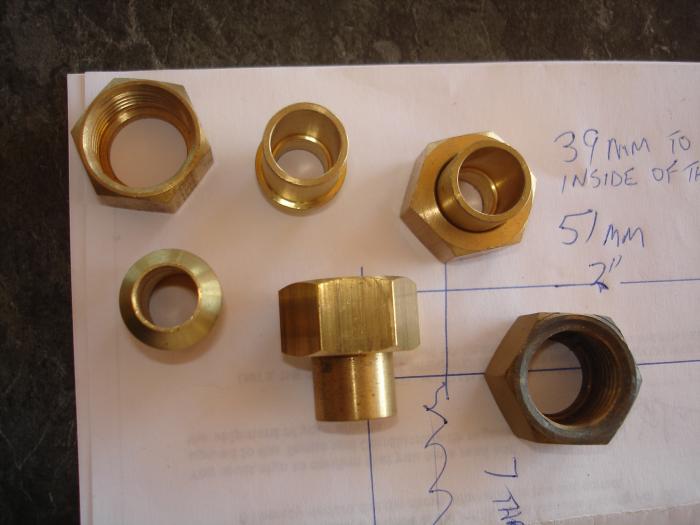

Can you put up a picture of the pipe ends? Are they not (Weatherhead?)fittings with an end sweated on to the pipe with silver solder (easyflo)
Much cheaper than a 250 pound flare tool.

These are Weatherhead fittings the dark nut is an original from a U.C. These were used in most carriers The Ferrule has a 1/2" bore to sweat onto a 1/2" o.d. pipe.
Ignore the crank handle cap.

Your photos look to show BSP pipe nipples. After talking to Andrew yesterday, he required flares on the pipes (opposite to cone nipples), which would sound right for a US made vehicle as that is the normal type of fitting used (JIC type with NF threads usually). As the Canadian carrier was based on a British design, did they not replicate parts and fittings? There are obviously detail differences between a US built T16 and the British designed Carrier and they cannot be compared on all details.

I am not familiar with the t16. I have no idea what Ford U.S.A. decided to continue with or change. I was merely showing that these fittings are still available and were used in the earlier carriers.
On the 31st Aug. Andrew mentioned the "special threads the T16 has" I was wondering if maybe the manufacturers had stuck with BSF.

thanks Guys, sorry I missed these updates. I should have responded to you Lynn, in that as Richard says, they are double flared fittings, much like a standard automotive brake pipe. The problem has now moved on! I can flare the ends in 1/2 inch but trying to bend the pipe in the intricate shape required to fit the vehicle has proven a tad tricky. I have however, left it with someone who is going to have a go at it for me. I only hope its not going to be one of those 2 month jobbies where you have to go and fetch it back as he has not looked at it yet! I am completely held up as nothing much can go in the engine bay without the pipes for the coolers being in. I will report back. Thanks for the thoughts.

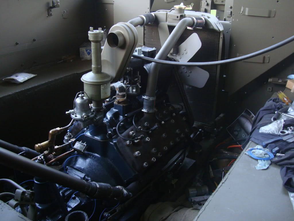

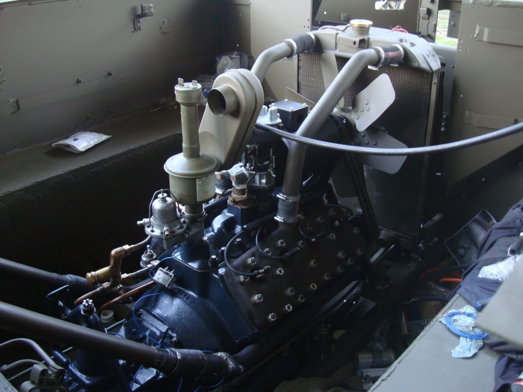

ok so she runs, and at the moment, she runs well. Have sorted out the timing, and subject to a full run all seems well. Hoping to take her for a run around the fields very soon.

so things are coming along very well, I have just made a bracket to carry the modern style 12v coil on the cylinder head, right bank. This is copied from the UK post war style 12 v coil adaption. I was talking with a friend the other day who had experience of the T16 and he told me it will only be a matter of time before the diving helmet distributor breaks down! cheery chap he is. He reckons I should fit the post wear Lucas distributor but stay away from the crab style which is even worse than the diving helmet! I must say that so far, the Diver has not given me any hassle at all and maybe that will change but I am prepared to assume that Ford USA worked it out before producing 13,000 with faulty distributors. If there is a problem with these, I imagine it must relate to the rotor arms or distributor caps etc?
Have received my wiring harness from the States and am gradually working through the wiring harness to make sure its all in the right place! The engine is running very nicely but I still have one leaking water pump. Now, I have not confirmed for sure where it is leaking from, but I am pretty sure its from the centre bolt, not the hidden bolt but the one above it. I recall reading somewhere that when you put this into the block you should silicone it. I didnt! can anyone tell me whether I should whip it out and add some sealant? It may be leaking from the gland and dripping down and appearing to leak from this bolt but I dont think so. Oil pressure is bang on the TM figures which seems low, but is between 25 and 30 lbs when hot which is what mine is achieving.
I reckon to be about 2 days work from being able to take it for a run around the fields , so watch out for the U tube video!
