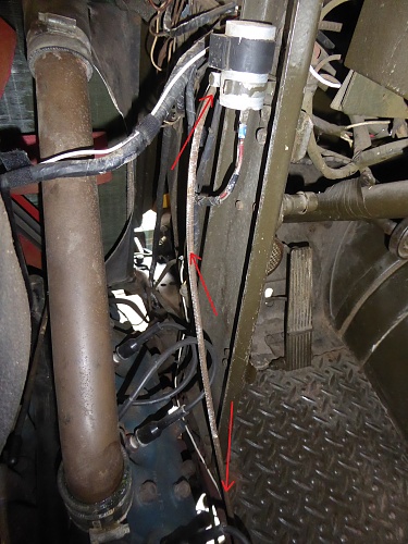

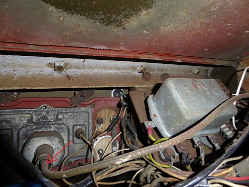

Well Jacques, I finally took to time to crawl under my 1943 F15A. I can't vouch for the routing to be the orginal one, but this is how it has been routed for the past decades and it works.

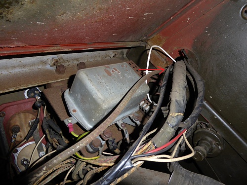

Behind the speedometer:
ID:	115066 Click image for larger version

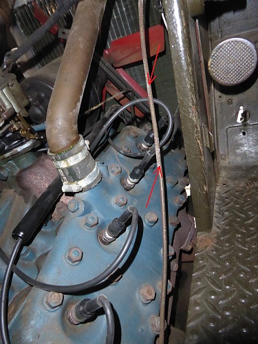

Coming through the engine cowling it dives straight down past the engine in between the 2nd and 3rd cylinder.
ID:	115068 Click image for larger version

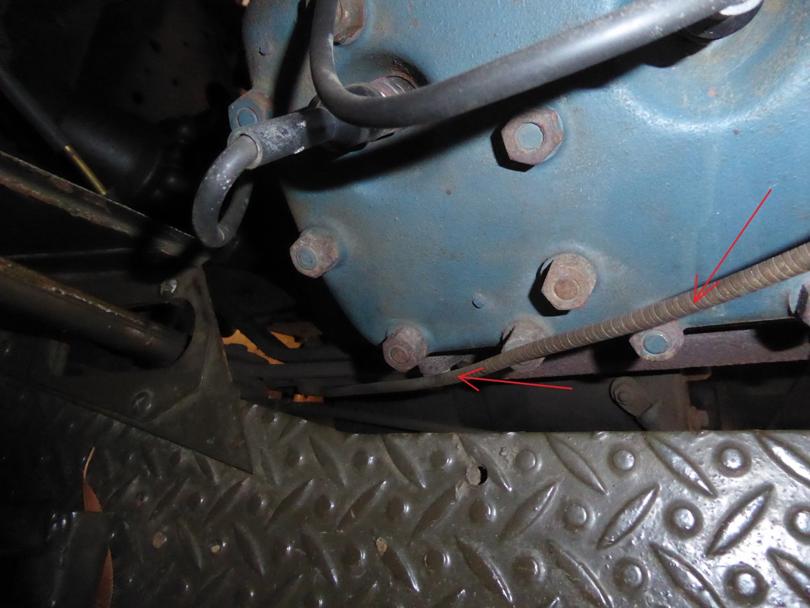

And then dives past the cylinder head into the chassis:

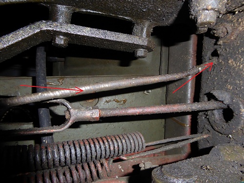

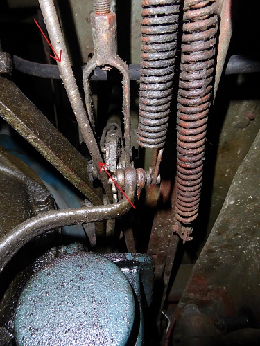

The speedometer cable somehow snakes in between the clutch and brake mechanism:

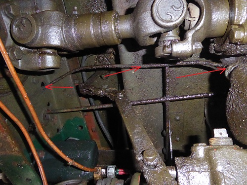

And then passes through the cross member:

Taking a close look for the first time I wondered about how loosely fitted this is. And I wonder how it manages not to get snagged by the clutch and brake mechanism? So not sure this is the orginal cable routing, though it is the shortest route from speedometer to transfer case.
I hope this is of some help.

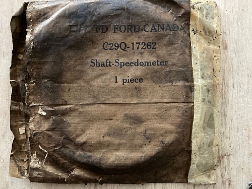

  #159
Old 18-07-20, 23:15
Default Shaft-speedometer C29Q-17262
I am now thinking 84" may be the correct length

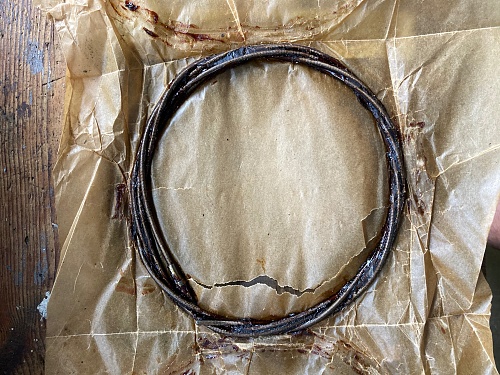

I have NOS shaft-speedometer C29Q-17262 for the F15A.
I unpacked it and measured it up. From tip to tip it measures 216 cm = 85 inches.
ID:	115074 Click image for larger version

For the F-15A:
*C29Q 17261- Casing Speedometer shaft. Used with new design cab
*C29Q 17262- Shaft Speedometer. Used with new design cab
I would think the lengths would be similar based on location of driven gear.

Old 30-07-20, 10:41
Default Cable routing
This could be helpful, there's a clip on the underside of the engine cover clip mount, and another higher up in this pic from the F60S assembly guide. It's from a pdf uploaded to my facebook group by Mariano Paz.
  #173
Old 30-07-20, 12:56
Thanks Keith, that image confirms the routing of the cable alongside the engine. I now know the cable on my F15A needs some clips to secure it.

Old 31-07-20, 01:43
VMVC
Join Date: Jul 2012
Location: Victoria Australia
Posts: 869
Default Ford CMP- Speedometer cable routing
Re. Mariano’s file, it is on the MLU Forum FB group also and I have shared it on the Forum here as well: http://www.mapleleafup.net/forums/sh...ad.php?t=31370
Hi Keith and Hanno,
That is great information again! Would not be surprised if the clips used to hold the handbrake cables at the rear springs are not the same and just repurposed.
It may also account for the hole on the frame of the floor.
I will still climb over paddock relics, just the same!

Now with the thought of an extended Covid19 lockdown in Melbourne I decided to have a go at shortening the cable myself. Could be 9 more weeks without being allowed to travel except for essentials.
Tony Ganmain kindly suppled me with an old cable and I was actually able to twist and pull the speedometer ferule off it. Yesterday I gently tapped some of the staking groove out of it and it is still a tight fit on my casing. I shortened the casing with a Dremel cut off wheel. Perhaps a bit of JB Weld for security and the same for the shaft where it goes into the tang tip. Worth a try anyway. I was told the cost to shorten mine would be the same as a new one so if it doesn't work out nothing is lost.
Will post results when finished.
