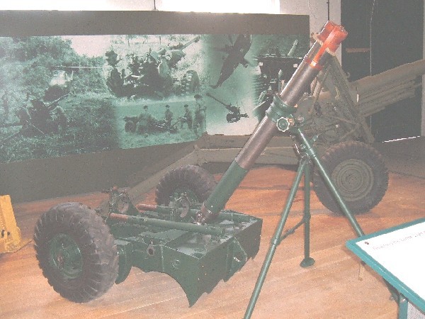

I canīt find much info on this weapon on the internet, and am interested to learn more about it in relation to the Carrier, 4.2 inch Mortar (T16).
Is this picture depicting the correct type?

You do have the correct Mortar. Attached (hopefuly) is a page from the long out of print book WW2 Fact Files on Mortars and Rockets.
There is another late war version which has wheel's on the base plate allowing it to be towed behind a jeep. This type remained in British Army service untill the 1960's. I believe the Dutch army retained stocks untill quite recently.

Having said it's original the legs could well be a post war mod looking at the pictures.

The gun in your original photograph seems to have some significant modications to my pictures. There was an American 4.2" Mortar but this looks significantly different again. I am not a where of any 100% original 4.2" Mortars in private ownership in Europe.
Indeed the American 4.2-inch mortar was an entirely different weapon.
The one pictured above looks similar to the one below, but yet there are differences which I can't explain. Who can tell what the (wartime) different models are of the British 4.2-inch mortar?

These pictures show the towed version of the 4.2" Mortar as used by British Airborne forces post-war.
This version would have been introduced very late war and probably saw no war-time service.
The pictures would appear to match the trailer version you posted earlier.

Pictures from the Wolwich Firepower Museum.

The wheel with holes around the edge with 5.00-5.25 tyres are the same as used on airborne trailers and some other WWII GS trailers. It seems these are what the towed mortar first came with and then late in 1945 they began changing the wheels out for the type found on 6-pounder guns with the lower profile wide tyres.
One of the features which I'd not seen on one of the mortars is this one has spring clips for the steel pivot bars. Very similar if not the same as those found on airborne jeeps for holding rifles and Bren guns. All others I've seen have hinged clamps to hold the bars and they look like smaller versions of the clamp used to hold the barrel while in transit.
