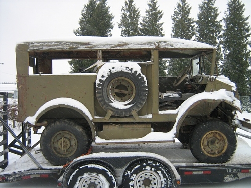

Ready for the drive...

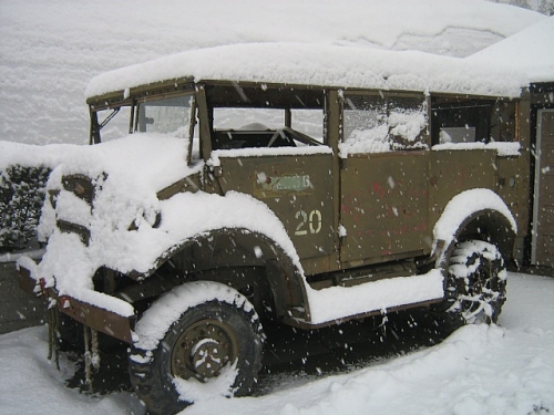

Upon arrival at home:

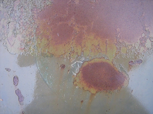

The driver's side 'hood'. Looks like a green over white shield with a white symbol of some nature.
The passenger side has the remains of a large number two in burgundy... possibly over white but I cannot tell for certain.
The passenger door is marked in white stenciled '81.966'

The HUP looks like it is in good restorable shape. Picking up CMPs in the snow is all part of the fun.

Default shield
The green thingy on the hood was a western command shield

From looking at the panel on the left side at the rear, I think your HUP may be a Mach ZL-2 model. Could you post a picture of the back. Is there a drop down panel opening on the upper left side? I am aware of 4 other C8As built on Contract LV2611 between May 11 and May 15, 1944 and all of them are Mach ZLs.
You could have a very rare model there. Are there any fittings remaining inside the body?

Ledsel, I had considered the Western Command shield but thought that was introduced in 1976 as a club. What is the complete story on WC?

My 1942 Diamond T wrecker has a Western Command Sheild on the left fender .It was around Edmonton AB and the Alaska hiway during the war .I have a 216 CHEV motor If you need it . To loosen a motor from rust PUT HALF & HALF, BRAKE FLUID AND DESIEL FUEL CONDITIONER .Fill the pistons to the top Leave it for a month and you should be able to move the crank . I saw this vehicle in Dease Lake but it was poring rain and very muddy so I never looked at very close at it . It looks very good ,little rust for that wet part of Canada Will look you up next time I'm out your way
