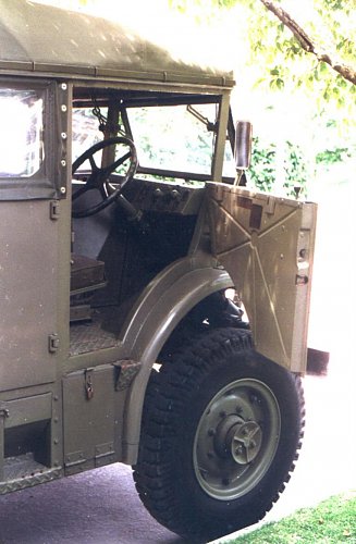

While attaching the pictures to Mariano's postings, I noted the design of the cab was altered. If you look closely, you can see the cab frame extends outward at the rear to merge with the rear part of the body which is wider than the standard Cab 13.

Old 25-05-15, 23:52
Interesting observation Hanno. Never noticed that before! "Armed" with this knowledge...it's quite obvious when you look at the fender, floor plates and lockers.
By the way, does anyone know if any of these 7B3 bodied FAT's arrived in NWE before the end of ww2?

Posts: 14,960
Alex,
Me neither; I had a closer look at one of the constructional drawings above, and noted the body is integral (cab and rear body are one).

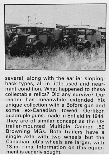

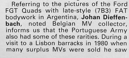

Mariano Paz spotted this snippet in Wheels & Tracks magazine no. 60. This photo was taken by Johan Dieffenbach in Portugal. This is the only indication I know of that the FGT with 7B3 body was used by the Portuguese Army
