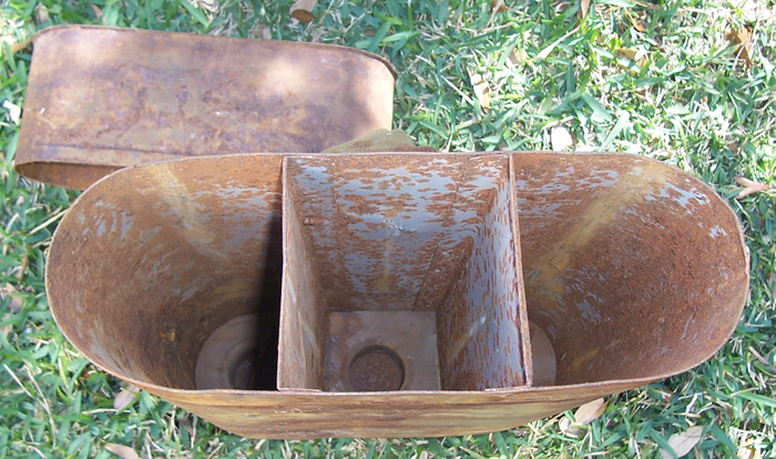

For the tubes for rounds, those in the photo should be bundles of two each which was standard for the 4.2" pattern during the war. Even the much larger wooden crates only held two rounds each. There is one other type of carrier for rounds which is made of metal which holds three rounds and it was designed to be carriered as a backpack. It is supposed to be for airborne troops but I have so far found no good documentation on it. I have one here and will try to take photos and post them this weekend for you to see along with what the crates look like.

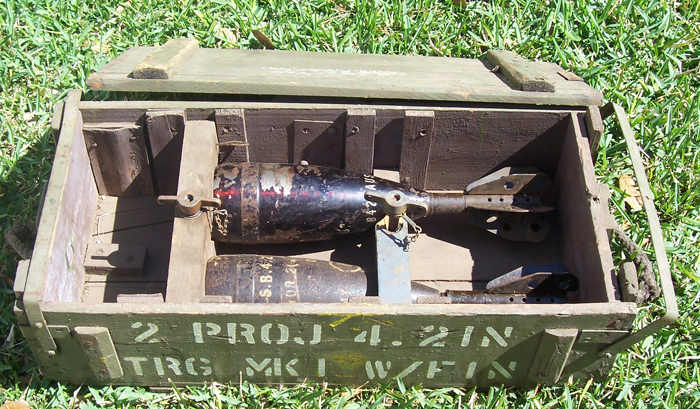

Shots below of the standard two round wooden crate for holding 4.2" mortar rounds and the metal backpack that held three rounds. Both items need restoration but are back burner projects for now. The two rounds in the crate are 1944 production and have no fuzes in them. Fuzes and the launching cartridges in a tin would account for the open space in the crate at one end.
