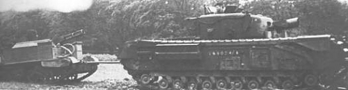

Originally posted by TColvin
Thinking about it, I suspect Conger was an engineless Carrier loaded with the hosepipe of nitroglycerine that was towed behind an AVRE.
Correct - here's a drawing:
Source: http://www.jed.simonides.org/

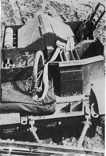

Looking down into the Conger carrier, showing the pump housing, hose storage and launcher

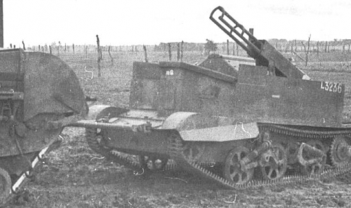

Pictures of a Conger on tow:
Mark

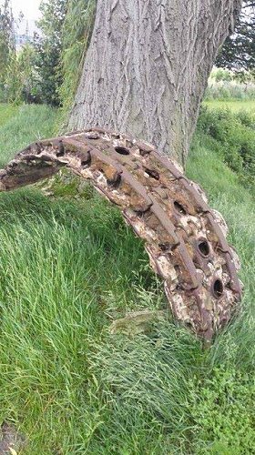

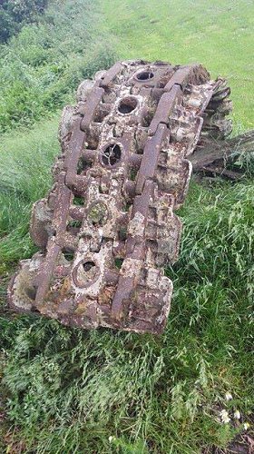

Churchill tank tracks found at IJzendijke (source)......
ID:	83471 Click image for larger version

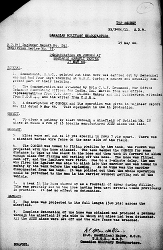

Conger Test Report FYI.
Tim
