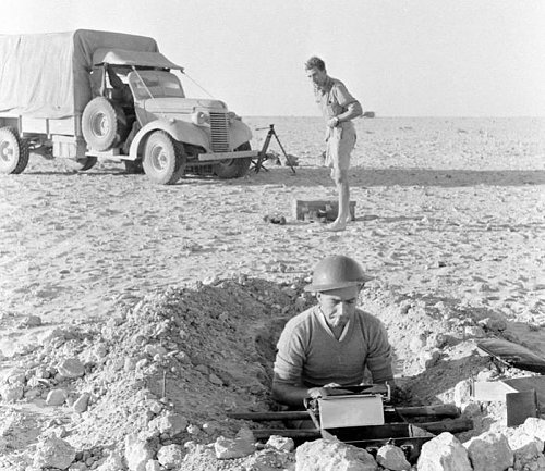

Is this the truck. Australian 6th Div. Lybia 1941.
ID:	34459 Name:  6divchevs.jpg

The left one looks like a 1939 VA, as the 1940 WA had a wider top grille part and less rad bars.
