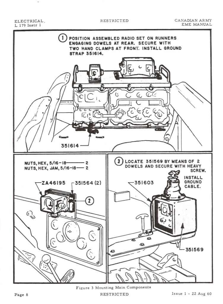

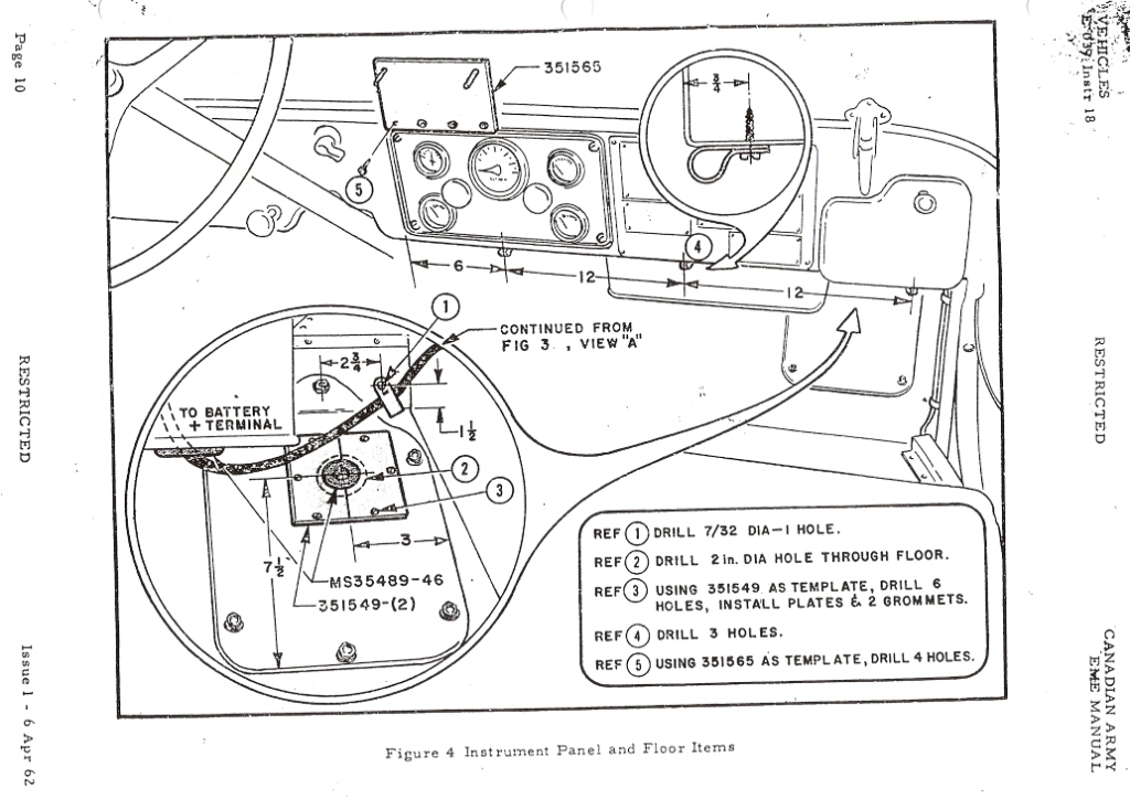

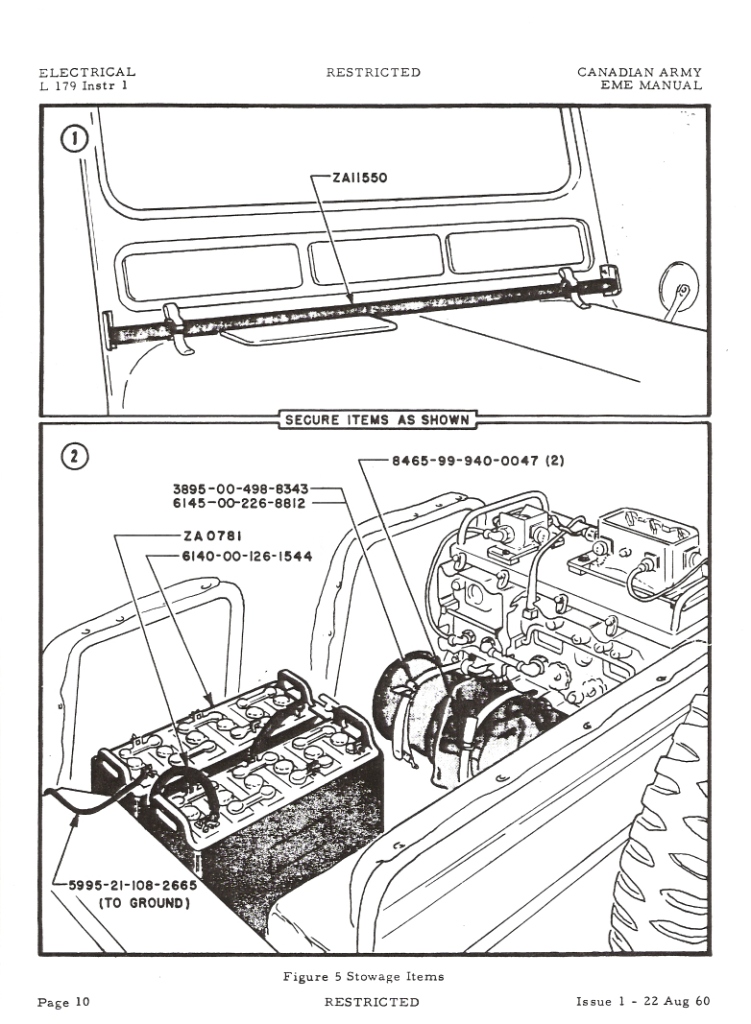

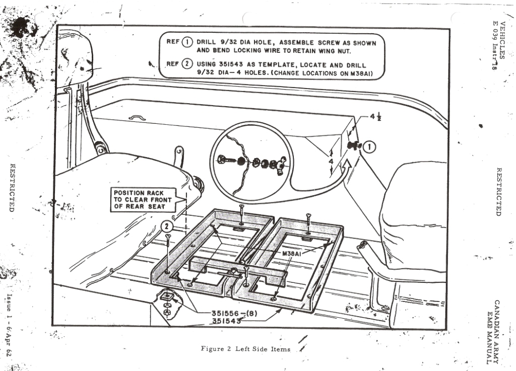

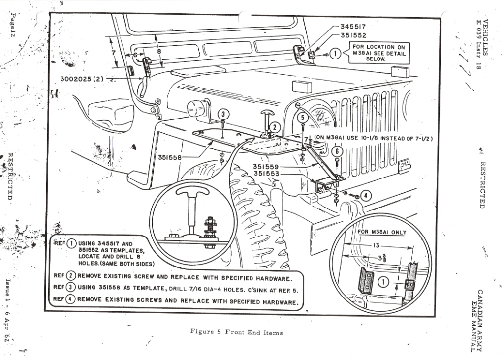

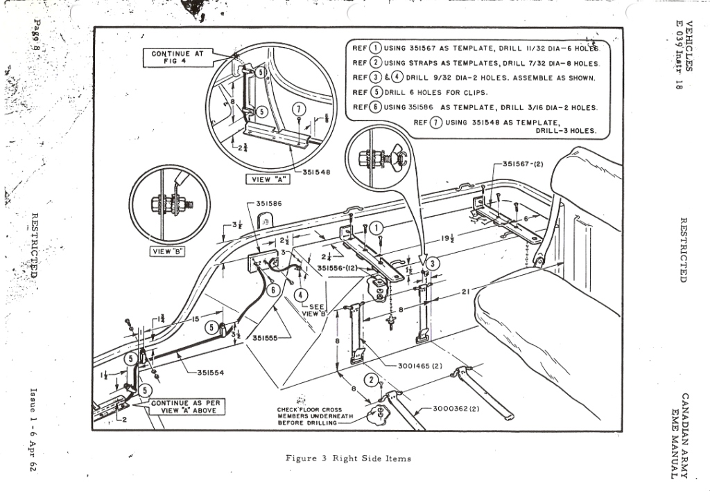

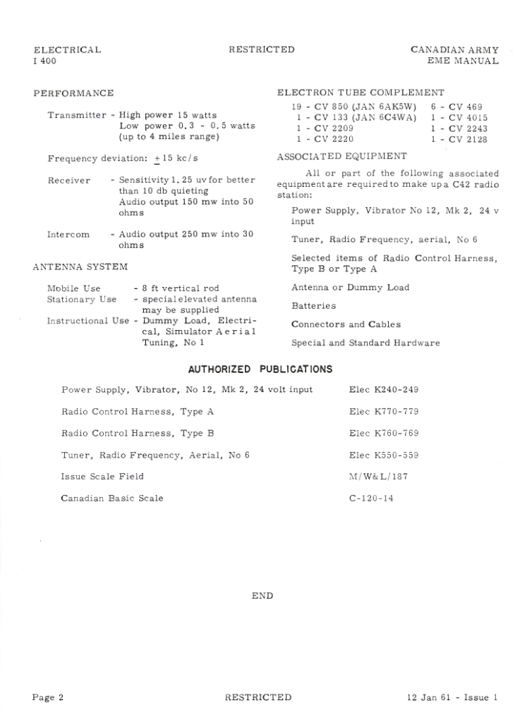

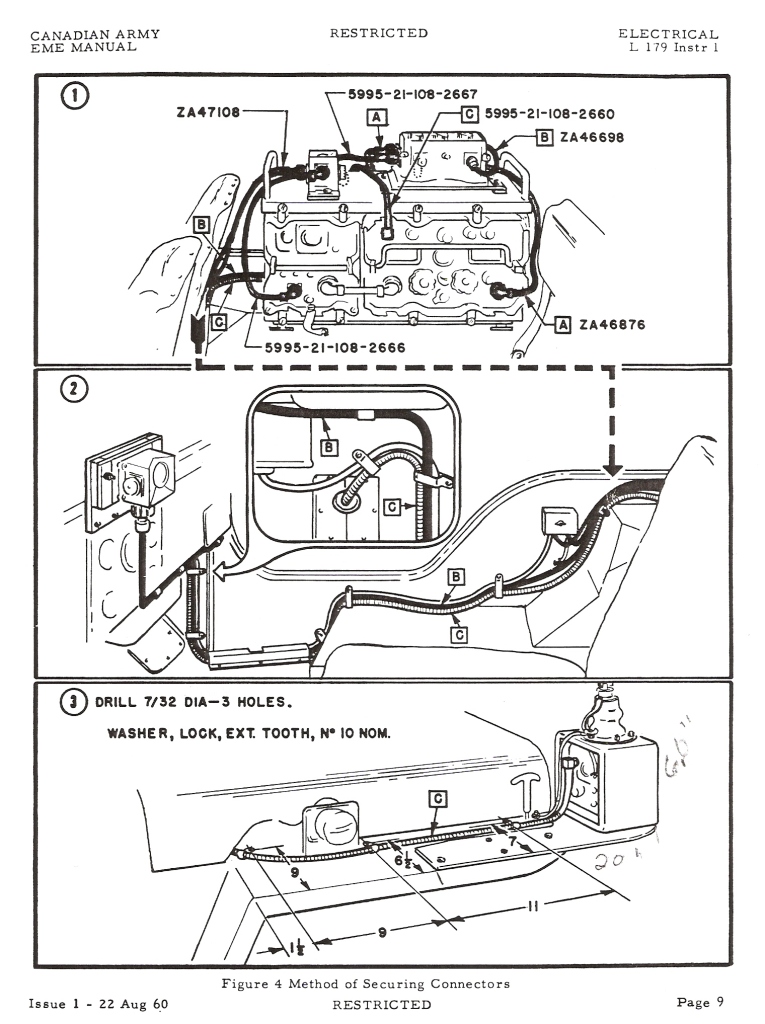

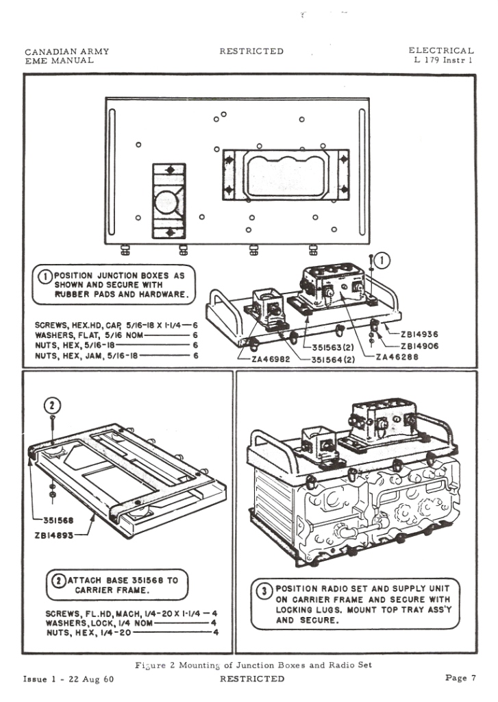

This Handbook covers the installation of the C42 radio set in the M38 and M38A1 series jeeps.I have copied the diagrams only out of the handbook as there are 30 + pages of info.You can use the diagrams for a reference to mount the hardware.Make sure you have the right mounting info for your jeep before drilling holes.

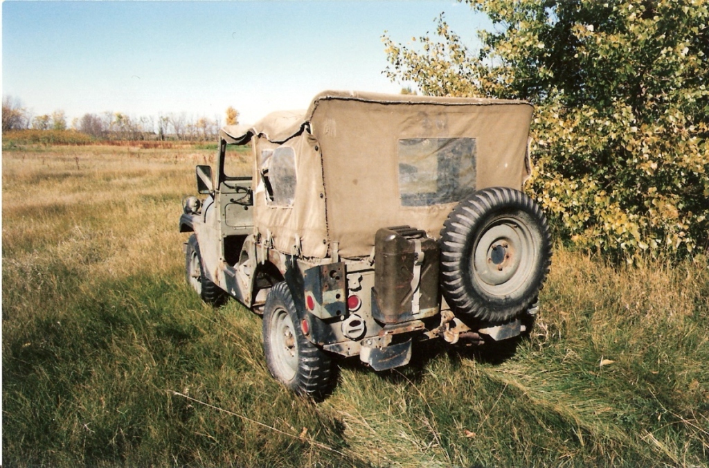

The radio mounts shown here are for the M38.The M38A1 had a tray bolted to the fender and the 2 brackets that were mounted to the radio slid into the tray and were bolted down underneath the front of the tray.Does anybody have a picture of the adapter tray I am talking about?
Here is the radio installation in my M38;

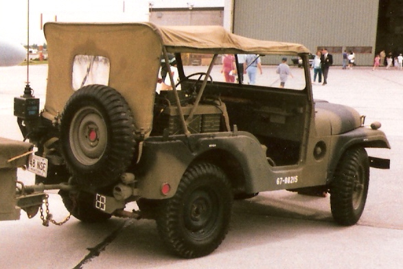

For the installation and mounting of the ATU and aerial mast for the M38A1 CDN2 series jeep,it was this bracket on the left rear corner.
Derk.
