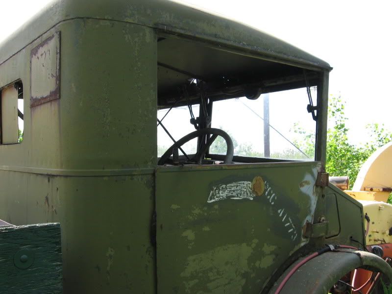

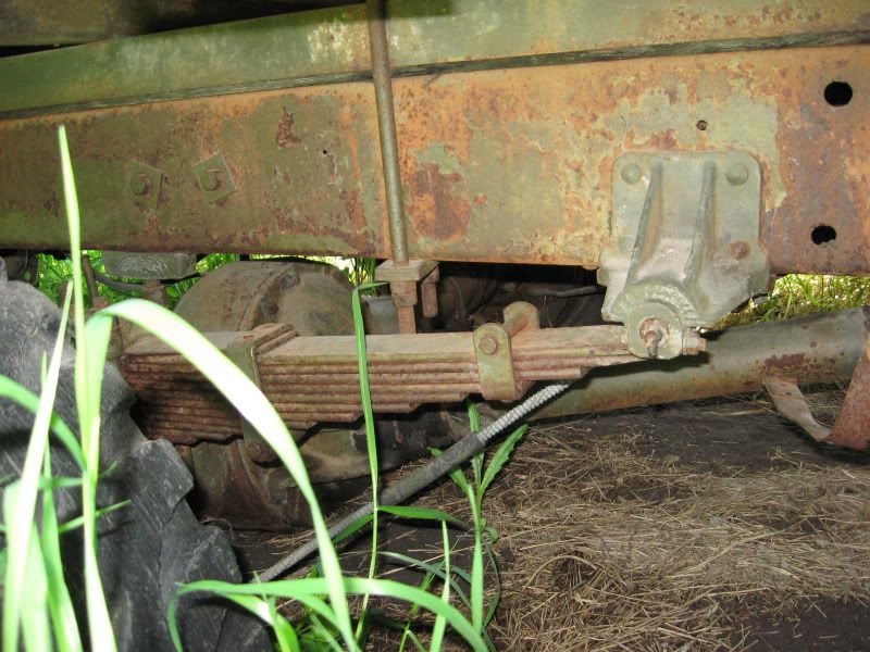

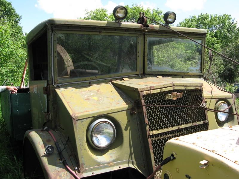

Here are some photos of a CMP C15a that I'm hoping to buy;
(that thing on the front is a snowblower, you can see the wires that held it on and adjusted the height/alignment of the blower. This will all be removed)
The fellow wants $1900.00 canadian for it. It runs and moves but probably needs an overhaul.
Now, my budget isn't large by any means so sweat equity is going to be my biggest contribution to this project. My wife and I own a small hobby/surplus store and I'm hoping to use this vehicle to bring gear and such to airsoft/paintball/milsim games and events around the city.
My eventual plan is to clean her up, sandblast and paint her, toss the old box and build a "troop carrier" type of box on the back with a tarp on top eventually.
So, I ask, is this doable within a reasonable amount of time and for a reasonable amount of money?

That has to be one of the straightest, cleanest, non-mucked with CMP's I've seen in a long while. While the pictures don't reveal a lot about the remainder, if what's not visible is half as good as the rest it's well worth the asking price. It is missing the correct box (probably a wireless body given the square patch behind the driver) and tire carrier but they all are. Some might even suggest getting the box first and finding the truck second to put under it.
As to the restoration, sweat equity will get you only so far and you will need tires, paint, bearings, seals, brake lines/linings/cylinders/drum turning, U-joints, wiring, hardware, etc., etc. Depending on how lucky you are and how original you wish to be, the restoration might range from $5,000 to $10,000. I figure if that's spread over three to four years, the annual expenditure is well within what other hobbies cost, but at the end you've got something truly magnificent.
Looking closer, the body appears to be the cut-off remains of an aluminum 2K1 Wireless body.

Bruce and Rick,
Thanks very much for the encouragement. I'll be giving the guy a call this week and giving him a deposit for the truck.
The box is indeed what's left of a wireless box. The fellow who came out to help me has restored three of these, including a very nice command post and he said it was a crying shame what they did to it but what can you do?
The bottom is still in one piece (and in the box we found both window frames) but there is a lot of junk back there (counterweight for the snow-blower) that will be tossed away.
It's a big project but I think I can do it. I'm a dab hand with a welder and there isn't much to be fixed on it. Though the loss of the bumper is kind of a bummer. Have to figure out how to replace that right off.

Sorry if I misled you. I don't know of plans with enough detail to build any of the Canadian boxes from scratch. Sketches with overall dimensions are in the AEDB Records but they aren't really enough to use for fabrication. Bob Carriere has been measuring some 2B1 relics that he has with a view to using them as partial donors or patterns for reproduction. He's likely to share his sketches if asked. If you can find a body to measure, even if it's beaten up, it sounds like you may be able to take enough measurements to replace missing or damaged parts. Some of the Manitoba and Saskatchewan members of the group may be able to let you measure original boxes or have leads to boxes that may be available.
The front bumper was a standard stuctural channel so can be easily replicated, particularly if you can measure the hole layout from an original.
Old 08-06-10, 05:23
I made a 2A1 for my 1940 cab 11 C15 but they weren't used with the cab 12 or 13 trucks. The 2B1 was used on the cab 13s in 1942 but that was it. Your truck has the round gauges so it's a 1944 or 1945 model and would have used the all metal 2C1 or the wood and metal 2H1.
