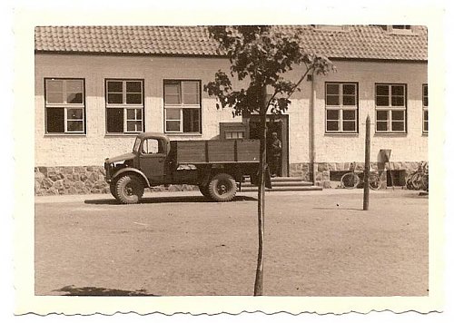

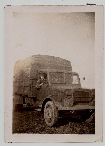

Here are a few Original photos from my collection/book
bedford tankers 2.jpg   bedford truck book 1.jpg   bedford mw.jpg   bedford mw 3.jpg   bedford va.jpg
Keith
