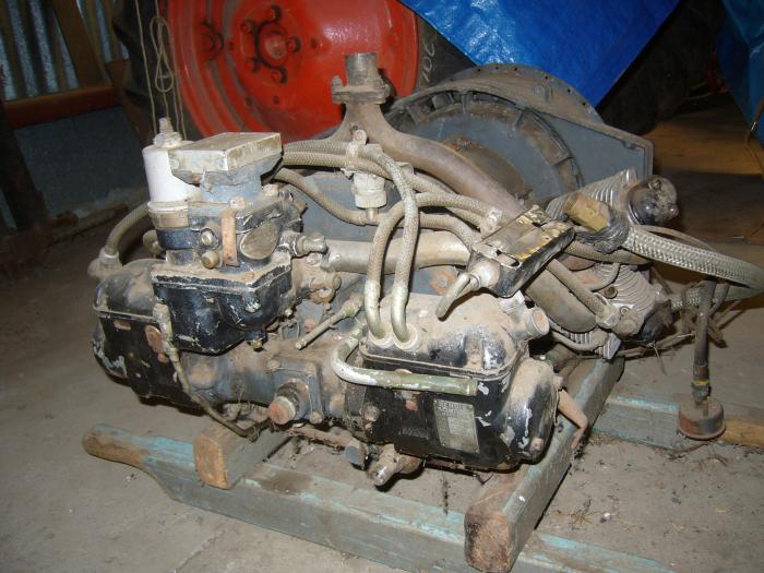

Hi all,
I have been asked to identify this power unit belonging to an estate.
The wife of the late owner said he had mentioned that it was for starting aircraft. Almost certainly military because of the shielded ignition harness. Has "Lawrance" on nameplate. My thoughts are that it may have had a generator attached and been an auxillary generator for an aircraft.
Any ideas!

Default Explosion proof
Originally Posted by lallat View Post
Hi all,
The wife of the late owner said he had mentioned that it was for starting aircraft. Almost certainly military because of the shielded ignition harness. Has "Lawrance" on nameplate. My thoughts are that it may have had a generator attached and been an axillary generator for an aircraft.
Any ideas!
It is definitely designed as explosion proof and would be necessary design for aircraft /hanger line use..It appears that you just have the engine part of the apparatus and the generator/starter part is missing..
If you contact Laurence Scott..they could give you more info..
http://www.laurence-scott.com/aboutlse/history.shtml
Here is the history of your generator..

Default Lawrance
Yeah but it says 'Lawrance' rather than 'Laurence'.
A Lawrance 5 cylinder radial w/ twin magnetos appears to have been in Boeing B-29's as Aux Gen power pack.
I think US manufactured aircraft would be closer to the answer.
