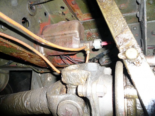

Secondly, I compared it with the setup on my F15A (built January 1943) which confirms to the configuration shown in fig.2:
Master brake cylinder with two brake lines:

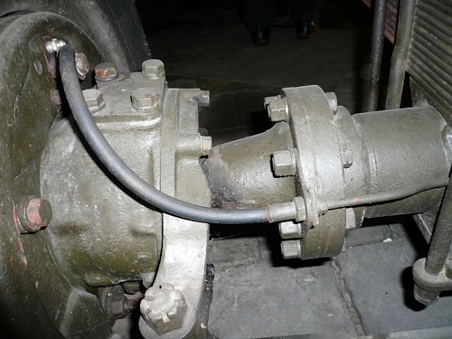

Left hand front axle brake hose:

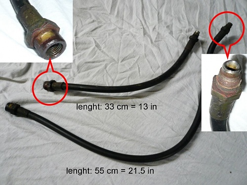

Brake hoses removed and measured up:
Hi Hanno!
Can tell me the correct length?
Is the same for F60 Laat?
Thanks in advance!
Mariano Paz

Hi Hanno!
Thanks in advance!
Hello Mariano,
See the last picture in my posting above (and attached below here again) for dimensions.
Yes, they are the same for all Ford CMPs.
